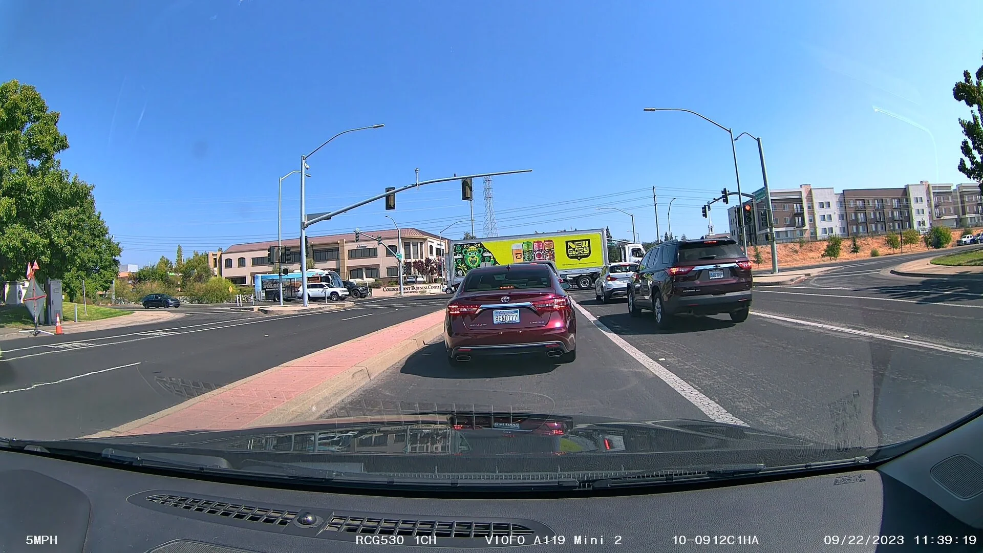

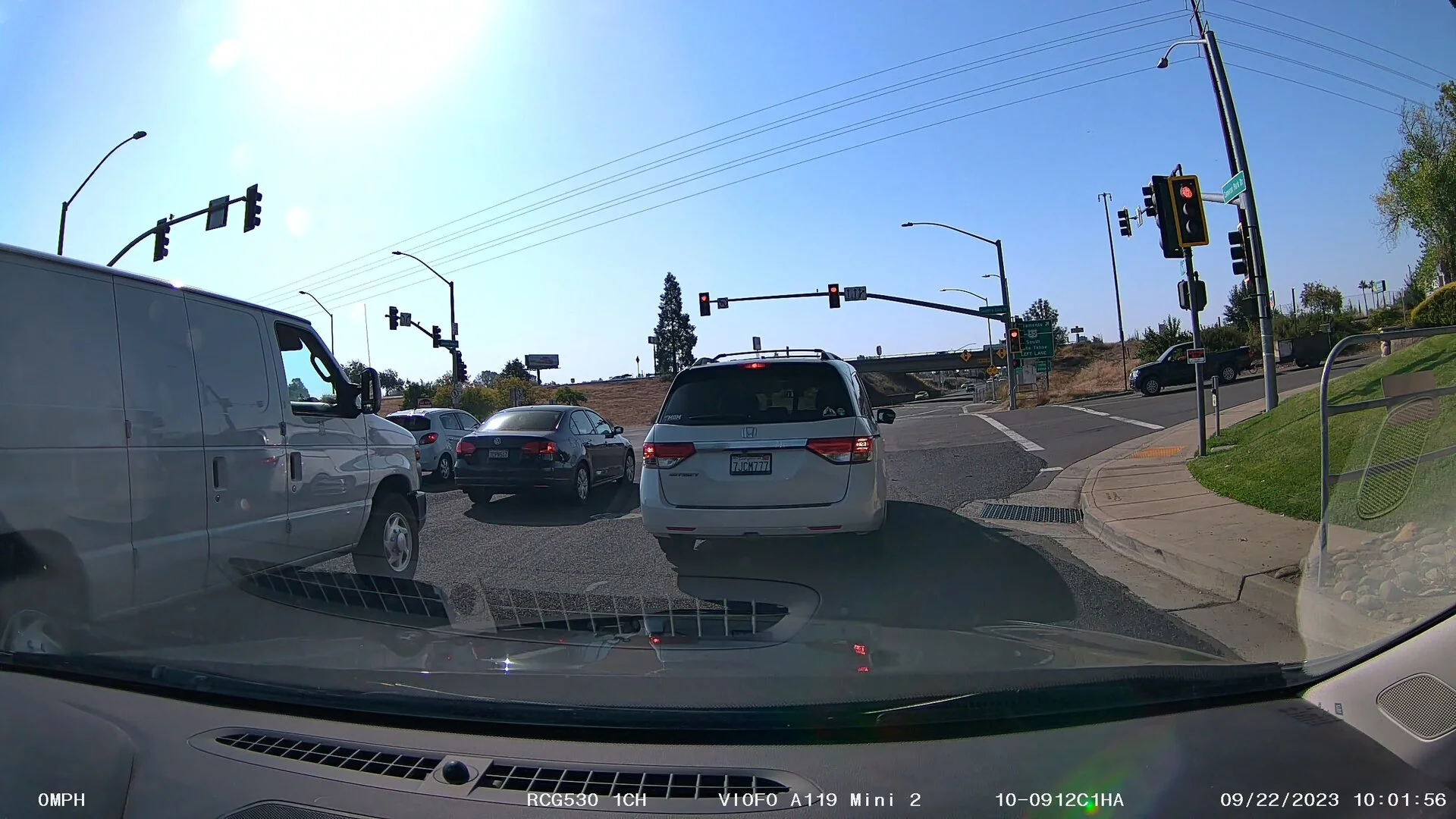

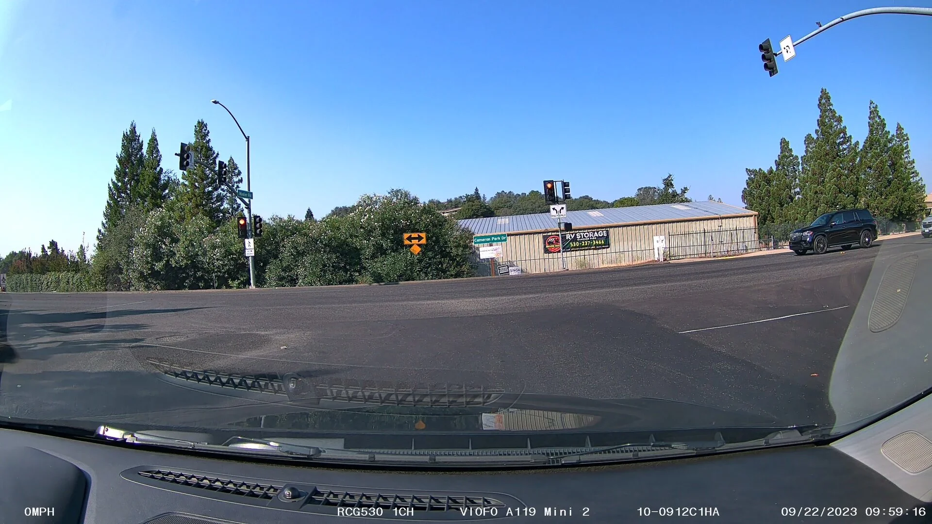

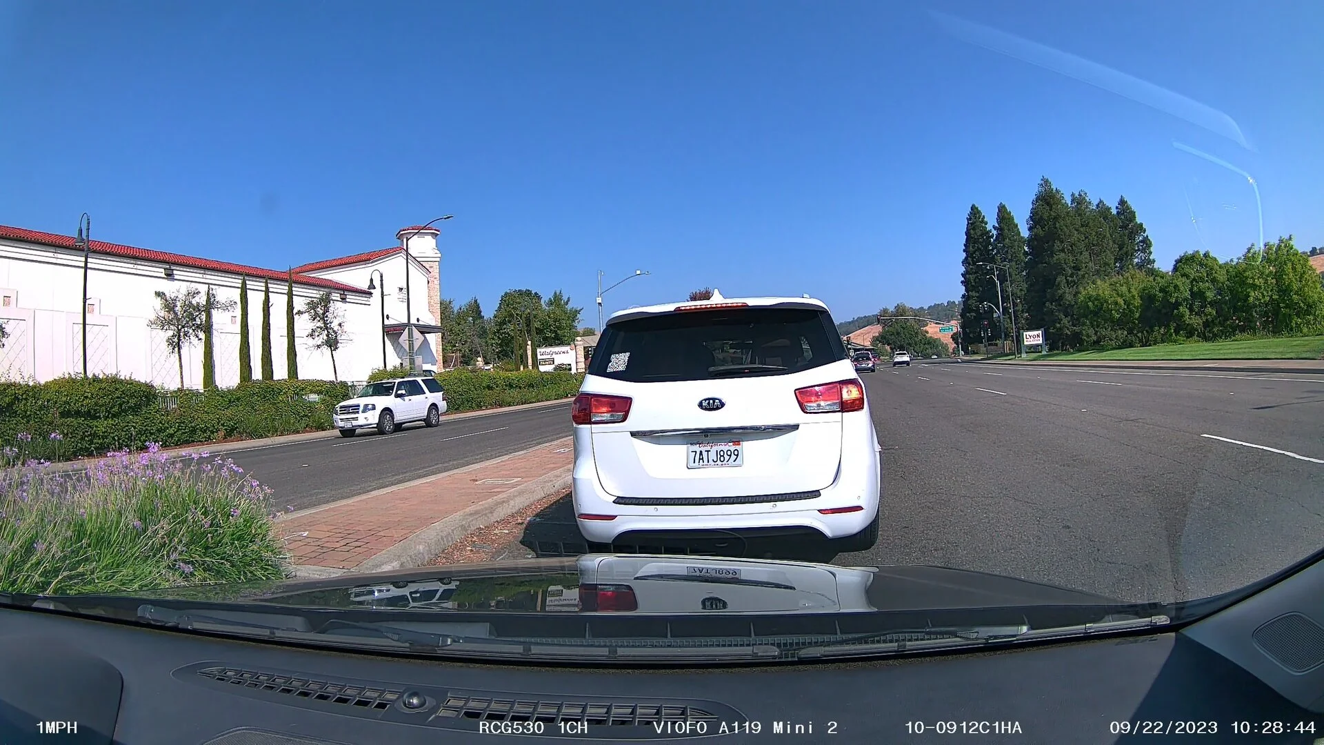

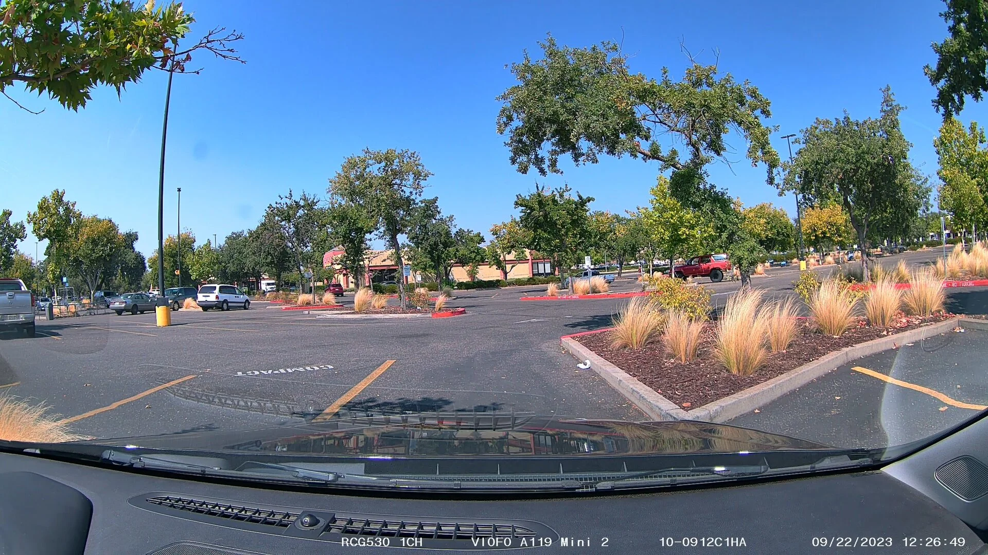

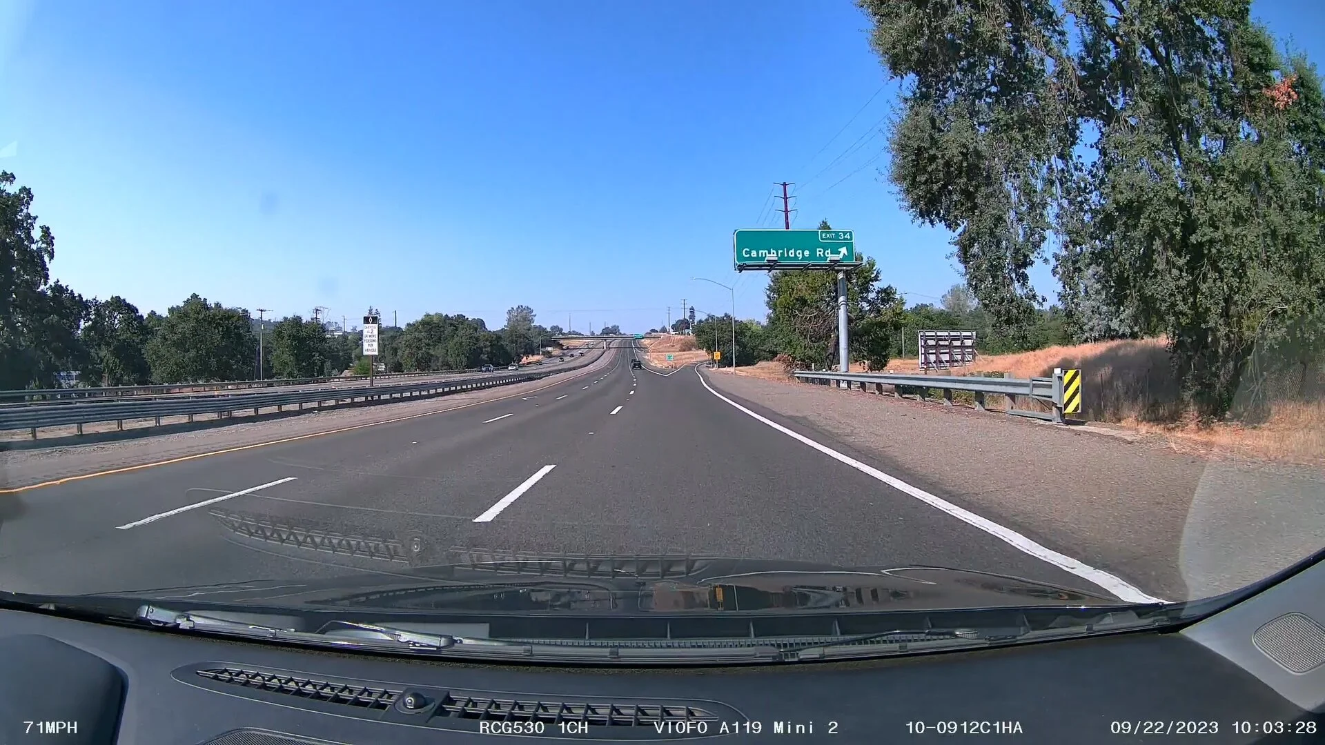

I received two A119 Mini 2 dash cameras with the updated lens. These two units are replacing the two A119 Mini 2 dash cameras that were sent by VIOFO that had problems losing focus when warm/hot. VIOFO stated that they updated the A119 Mini 2 lens with the lens used on the A129 Plus. I have limited front windshield space, but I had enough room to get one of the updated A119 Mini 2 dash cameras installed.
I'm happy to report that the lens stayed in focus during my weekly 3 hour shopping trip route. With the original A119 Mini 2 dash camera installed and at the end of the third longer parking mode session, you could definitely see a large focus problem. I must note that the temperatures in my area have become unseasonably cool for this time of year. The passenger compartment was reaching the upper 90s F by the end of the last parking mode session. It would get up to 120F in that same car back in August of this year. I'll have to do more testing, but so far the A119 Mini 2 dash cameras that were manufactured starting in July 2023 appear to have a lens that is more stable with regard to focus issues.
If you have one of the earlier A119 Mini 2 dash cameras with a lens that goes out of focus with exposure to moderate to high heat, VIOFO stated you should open a support ticket with VIOFO and you will need to provide evidence of the focus issue with your unit. After VIOFO confirms your unit has this heat related focus problem, VIOFO will replace it for free. VIOFO has stated that very few customers have reported this problem. I have to say that all three units I tested, one that I purchased from Amazon and then returned and the two original units sent by VIOFO, all had this problem.
Here are some screenshots from my 3-hour drive:
a119_mini2_01_20230922095813_000006.MP4_snapshot_01.03.jpga119_mini2_02_20230922100113_000007.MP4_snapshot_00.43.jpga119_mini2_03_20230922100113_000007.MP4_snapshot_02.15.jpga119_mini2_04_20230922101013_000010.MP4_snapshot_00.54.jpga119_mini2_05_20230922102614_000017.MP4_snapshot_02.28.jpg
a119_mini2_06_20230922110052_000029.MP4_snapshot_00.04.jpga119_mini2_08_20230922113912_000043.MP4_snapshot_00.07.jpga119_mini2_09_before_parking_mode_20230922114812_000046.MP4_snapshot_02.19.jpga119_mini2_10_after_parking_mode_20230922122647_000059.MP4_snapshot_00.03.jpg
View attachment 67716View attachment 67717View attachment 67718View attachment 67719View attachment 67720
View attachment 67721View attachment 67723View attachment 67724View attachment 67725
A screenshot from one of the original A119 Mini 2's with original lens from August 2023. This is after the last parking mode session.
Hey there! That’s is great news. Thanks for the info and your time and efforts.
I am guessing that any Mini 2s purchased now would have the corrected lenses? Maybe VIOFO can comment?
thanks again.
thanks again.
I'd say so,. production batches would be fixed and sent out to storefronts

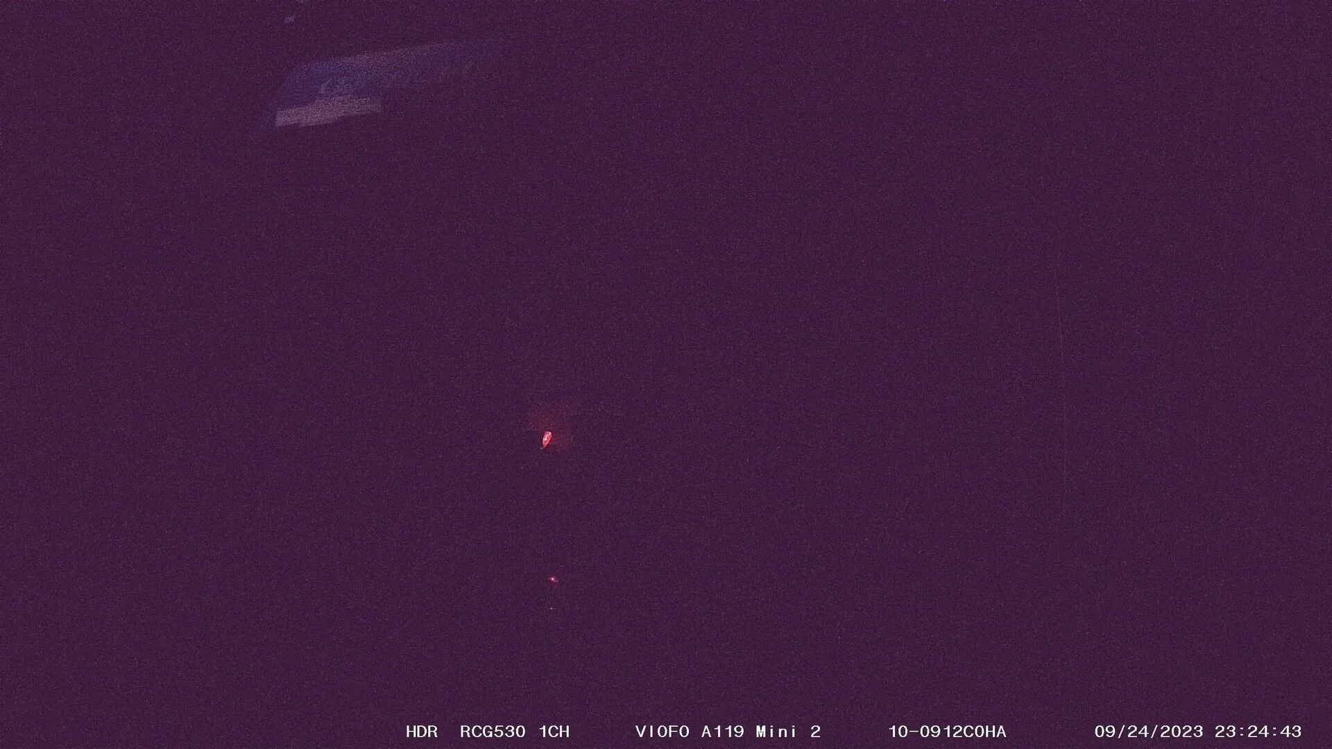

While testing another VIOFO dash camera, I was using the A119 Mini 2 to capture comparison video footage. I found that when the light level is very low or totally dark the A119 Mini 2 video will have a purplish hue. The other VIOFO dash camera did not have that same issue. I mentioned this issue to VIOFO and it was stated this could be resolved in a future A119 Mini 2 firmware update. This test was with A119 Mini 2 firmware v1.0_20230912 installed and the HDR feature was enabled.
Here are two screenshots from the A119 Mini 2 footage. The left screenshot is from testing the HDR feature with only a flashlight shining directly on the plate. The second screenshot is with a completely dark garage (except you can see the glow of a power strip illuminated on/off button in the lower left).
a119_mini2_hdr_c0ha_20230924232332_000075.MP4_snapshot_00.50.jpg a119_mini2_c0ha_purple_when_dark_20230924232332_000075.MP4_snapshot_01.12_[2023.09.24_23.46.15].jpg

I found that when the light level is very low or totally dark the A119 Mini 2 video will have a purplish hue. This test was with A119 Mini 2 firmware v1.0_20230912 installed and the HDR feature was enabled.
Do you get similar results with HDR off?
VIOFO did provide a v1.0_20230926 test firmware for the A119 Mini 2 and the purplish color when the scene being recorded is completely dark has been resolved.
Screenshot from my dark garage with the updated firmware installed:
It is already fixed. We have sent a new firmware to @rcg530.
