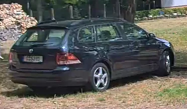

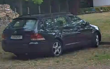

Here are two screenshots. The first screenshot was taken in the parking lot after 19 minutes after turning on the Mini 2.
The second screenshot was taken in the parking lot after 115 minutes of running the Mini 2 in the parking mode: "Low bitrate recording".
On the left side, the effect of heat on the lens, that is, defocusing, is very clearly visible.
It turns out that this problem also affected my copy.
Although I did not notice this on V3 and Mini.
View attachment 66563 View attachment 66564
I find it difficult to see a big change in focus between these images. The sunlit image (after 19 minutes) might appear sharper due to higher contrast.

View attachment 66729 View attachment 66730
That's what I meant above. my mounting location is to the right of the mirror, but it is a little further to the right since there is an occasional camera. I will try to put it out. I will see if the right and left will have equal problems.
I am not saying the focus has not shifted, but an example with similar lighting would be better to compare.
I can't stop time and the sun. They live their lives.
To the left of the car there is a wooden structure. It shows very good soap.
Here you can compare with N5.

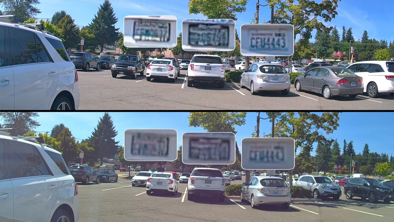

I'm working on my A119 Mini 2 video now and this heating issue is making it tougher to find footage to share for the video, heh. Here's a quick A/B comparison with the car parked for about 1 hr 45 min in the sun. The top half is when I arrived. The bottom half is when I was leaving.
That's why I suspended my review until this issue is resolved by VIOFO.
Is there any part of the frame in the second video that is sharp? Or does it all go slightly blurred? Sometimes with focus shift, your dashboard or wipers appear more detailed.

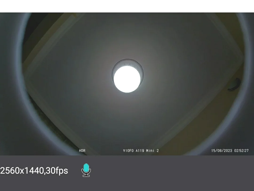

The left side sharpness problem is that the captured image is shifted slightly to the left.
I tested this with a tape. you can try too. When you think of the left image as a square, there are more angles to the left. This can cause blurriness.
@viofo @VIOFO-Support I tried to shape it amateurishly. inside the red square is the current image area. It is a little bit smaller than the green area that should be. i.e. the current viewport appears to be shifted to the left. This is software related.
Can you trust a screenshot from the live view?
I've found the live view image is not 100% identical to recorded footage that's been downloaded, before being analyzed.
I tested it with an even circular tape pad. usually the left side is blurred. So I see that the viewing angle is more angled to the left.
You can do the same test with another object.
For example, take a stick and hold the stick across 90° and check if the stick is right in the middle of the live view.
Live view is the same as video recording. checked.
