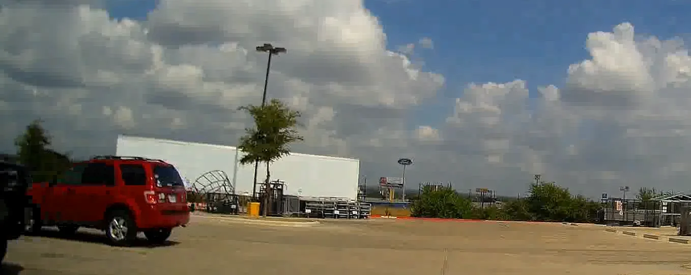

This is a clip from the now working A119S. I think the blur is still there. That issue was never fully addressed after the ribbon debacle. I may get to that eventually but still can test out mods in the meantime. I only muted the audio (To Many Foul Words) in the video editor and selected a mpeg 25k bitrate for the output.
Parking Lot Clip
My tests so far show that too much sharpness (and/or framerate) and not enough bitrate gives blockiness and 'mosquito' artefacts that ultimately greatly decrease car number plates legibility (more so at a distance).
Therefore, to some extent, we can actually increase numbers readability by reducing sharpness.

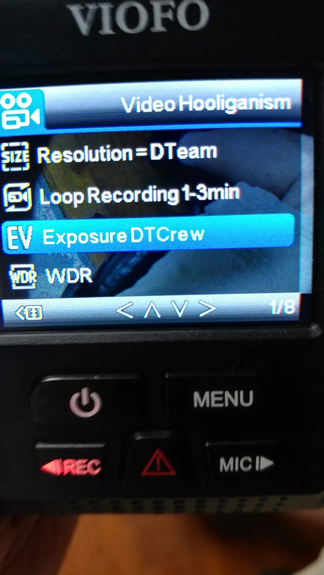

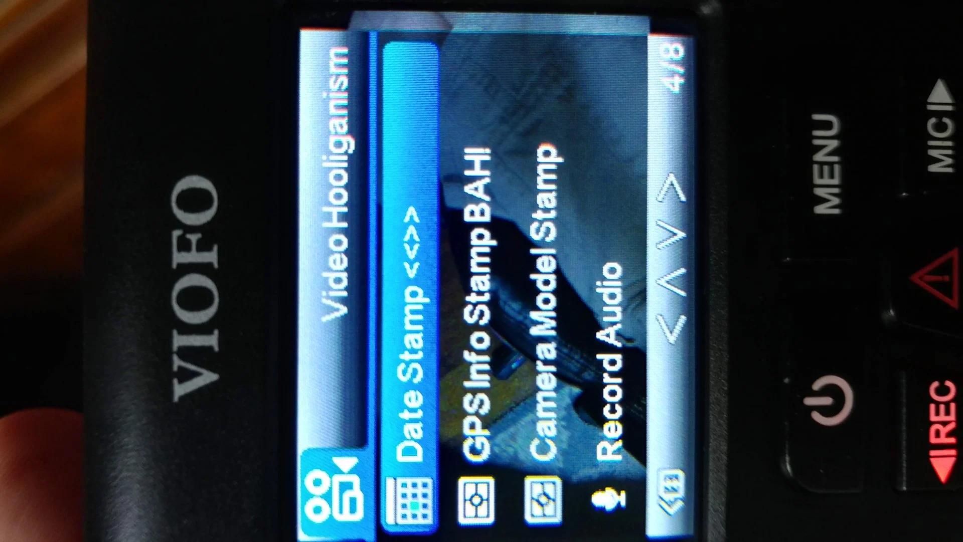

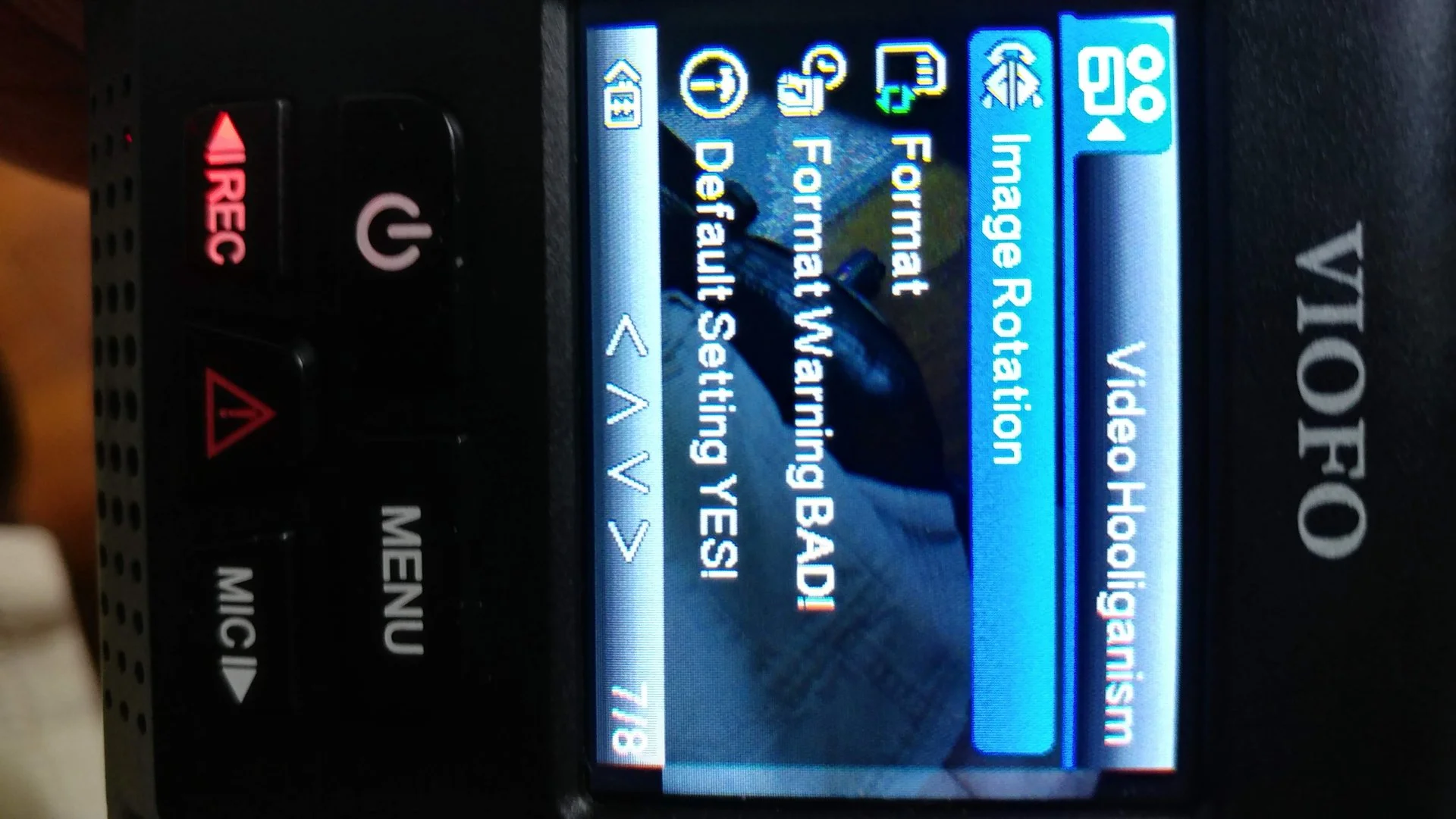

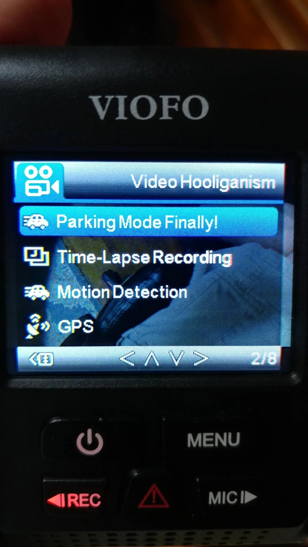

There are changes! The Names have changed but the functions are still the same
MENU Hooliganism = 27 changes
Video Hooliganism
Resolution < DTeam
Loop Recording < 1-3min
Exposure < DTCrew
Parking Mode < Finally!
5fps<
Auto Calibration < ADD! << A119S current Firmware already includes this feature but HIDDEN
Brightness < ADD!
Sharpness < ADD! << A119S current Firmware already includes this feature but HIDDEN << done by MODs
Saturation < ADD! << A119S current Firmware already includes this feature but HIDDEN << done by MODs
Contrast < ADD! << A119S current Firmware already includes this feature but HIDDEN
White Balance < ADD! << A119S current Firmware already includes this feature but HIDDEN
Low Sensitivity<
Date Stamp <<>>
GPS Info Stamp < BAH!
Speed < DOH!
Screen Saver < Posse
Boot Delay < Finally!
Date/Time <<>>
Beep Sound < BAD!
Startup Sound Only<
Frequency < Set
Format Warning < BAD!
Default Setting < YES!
Car Number = Text
Firmware Version < MOD
A119_v2.61-5E+25Mbps
Download Menu-MOD to see the future: https://drive.google.com/open?id=1il-CbgLY3M4UVdNMXXwW3U8tt2effM0j
