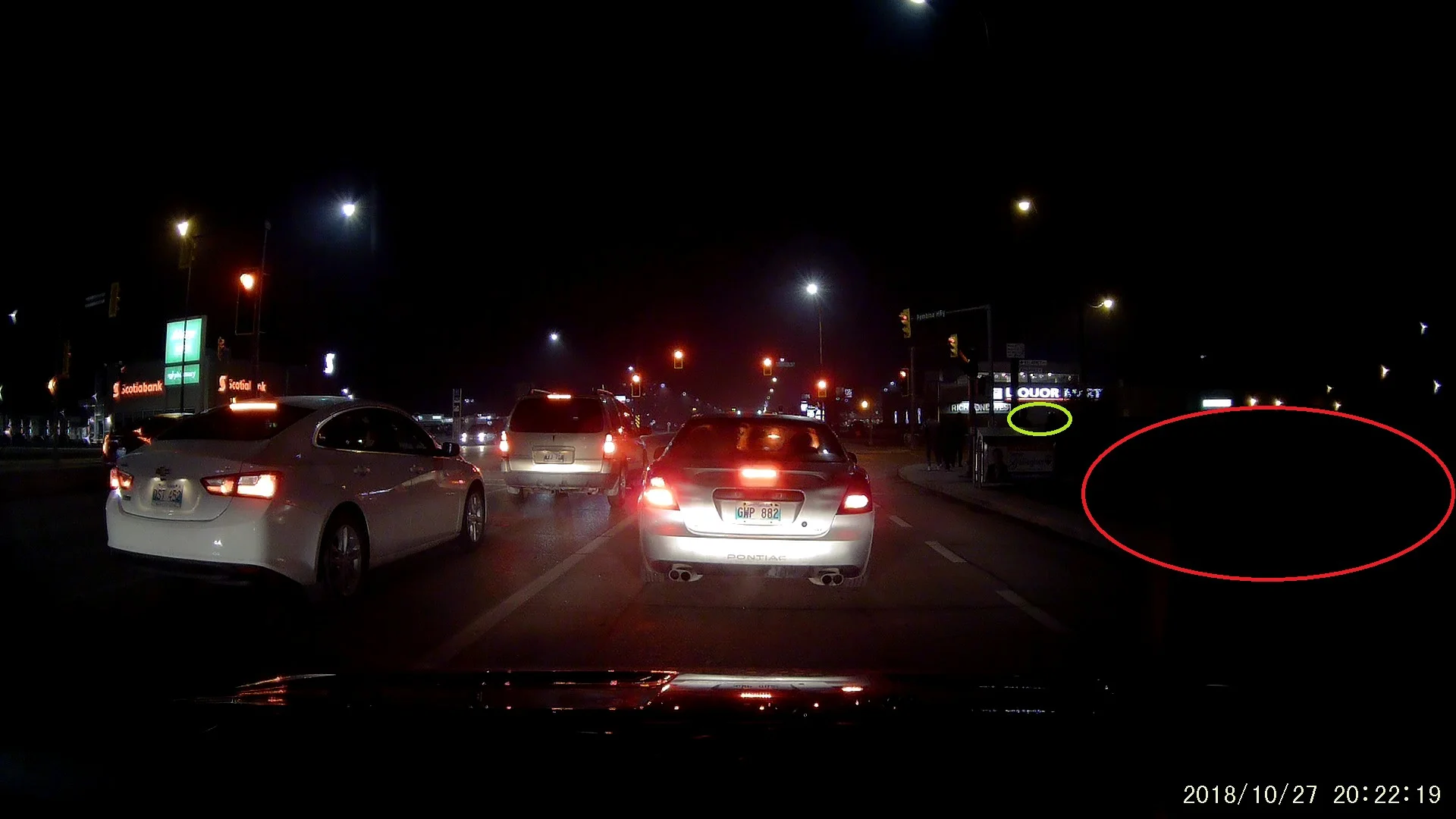

If you watch the clip again you will notice that those two people marked with yellow are passing on the sidewalk marked with red. Well, let's pretend like they are going to shoot you, or... they are getting robbed.
You have nothing on the camera, even though the car is very close.
In my opinion this is unaccetable for IMX291, even with WDR Off.

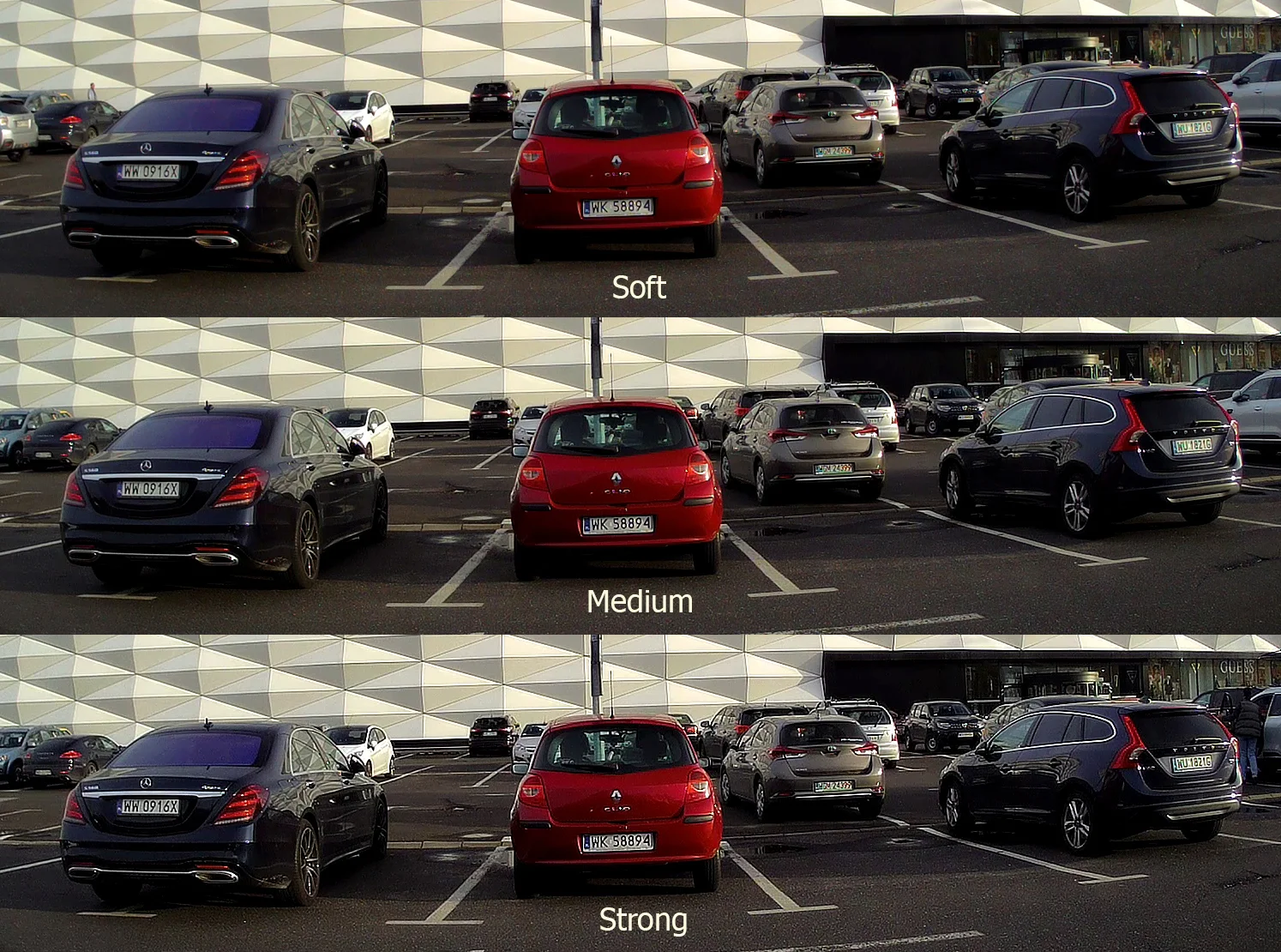

Some 6Nq clips from today:
normal sharpness - quite good, similar to v1.01 - https://drive.google.com/file/d/1e9tDoWpO3POI0JLOr_SWG3AOmdS03oiT/view?usp=sharing
strong sharpness - too much plastic, but pleasant to watch - https://drive.google.com/file/d/1FGznoyeBioSHtT--AoW4vK-O1ntBCXFI/view?usp=sharing
soft sharpness - who would ever want soft? - https://drive.google.com/file/d/1QhjohGisNNZpMasjWASMFCBoiXio9SnZ/view?usp=sharing
Normal is a tiny bit sharper than real life, as far as I can see it; sharpness value 56 might be a sweet spot and should be the minimum, me thinking.
