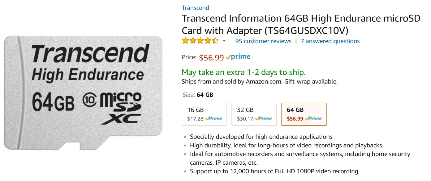

Could you please tell me the exact model number of the Transcend sd card that you bought? I can get a card imported but I am worried about the warranty...
This is the one i bought from Amazon,but i paid more then this price.
