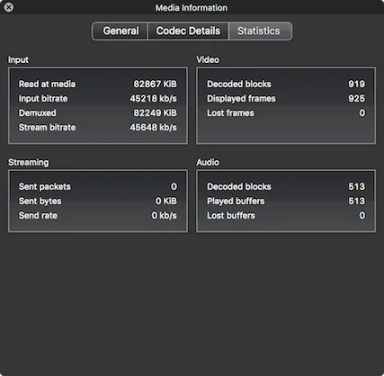

You didn't answer my question. Many people have reported playback issues at 60 frames per second. Codecs and choice of media player is an important part of the equation but without the proper graphics horsepower there are bound to be issues.
It would not surprise me that WinXP performs well. Many people, including me really miss it but finally gave up on it for security reasons and lack of further support from Microsoft.
VIOFO A119S (F.W V. 1.7) - 1080p @ 60 FPS, WDR - On, CPL - No.
The bitrate averages at 25 Mbps, still spikes up to 45 Mbps with 60 FPS. Almost 600MB for a 3 minute segment.
