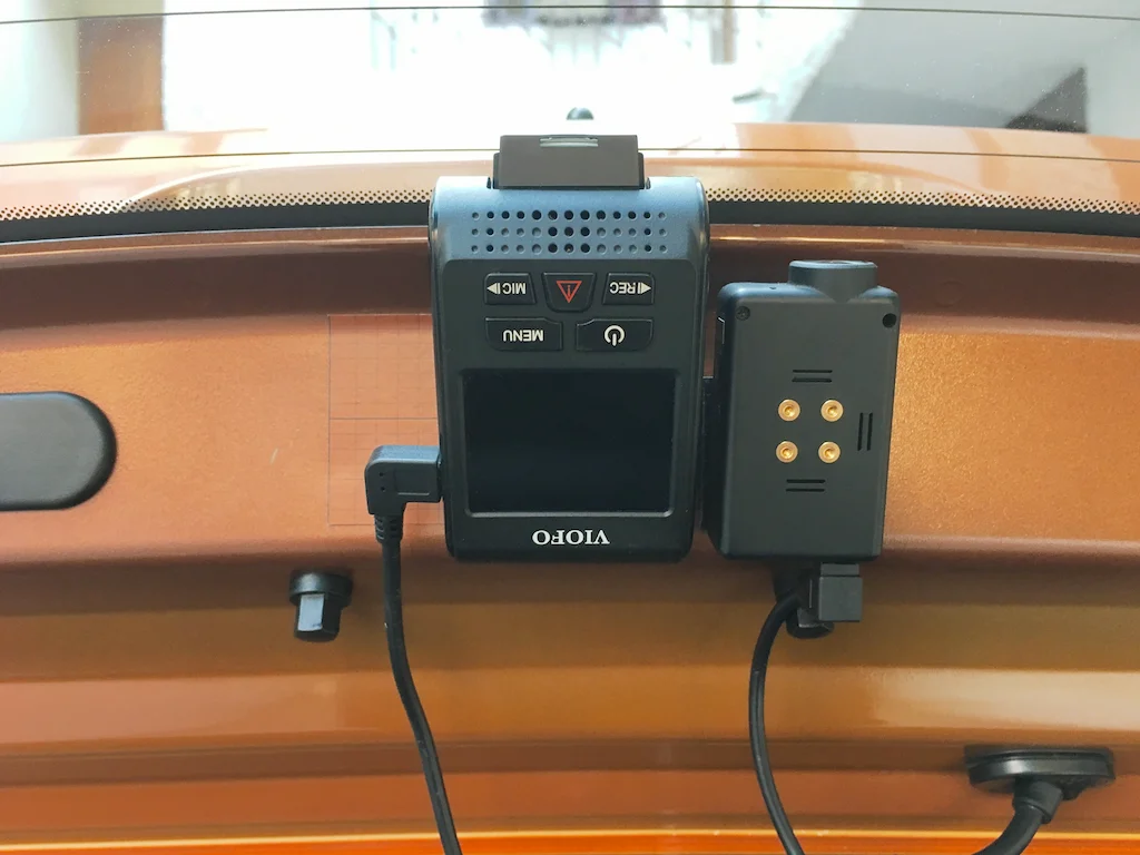

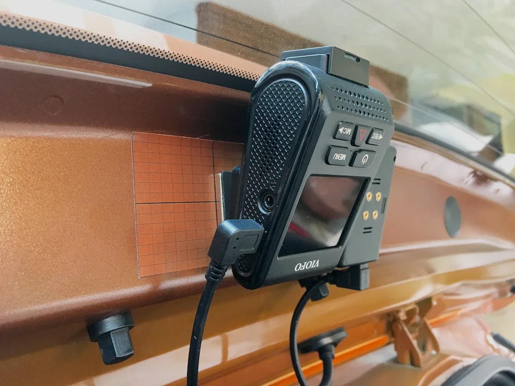

Going forth I plan on using the A119S mostly as a rear camera. Will keep adding videos as new firmware revisions with IQ changes/enhancements are released.

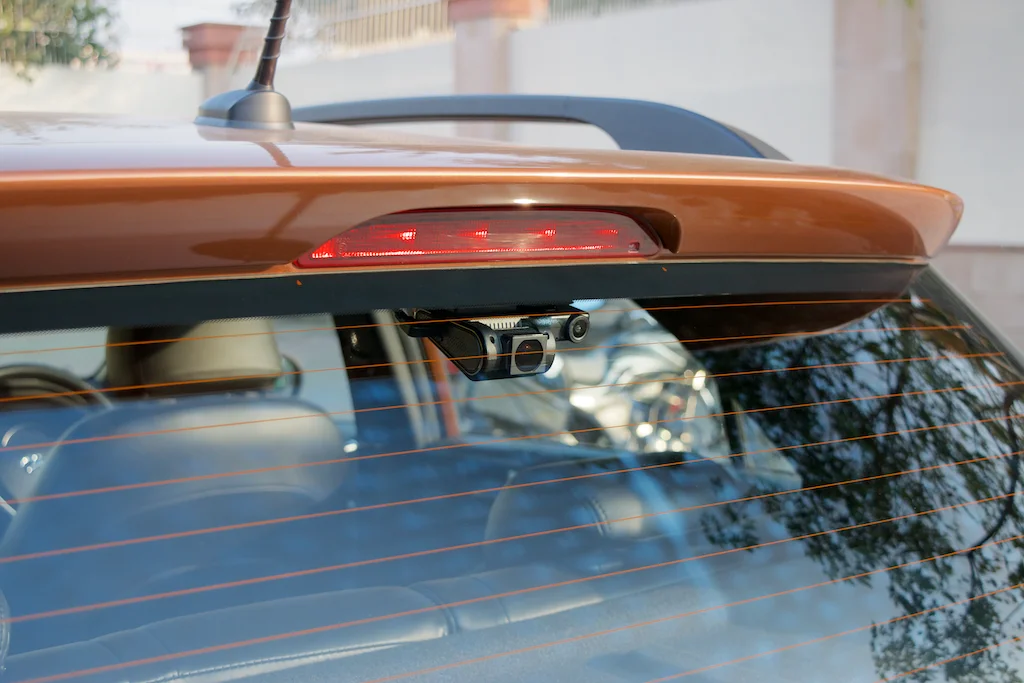

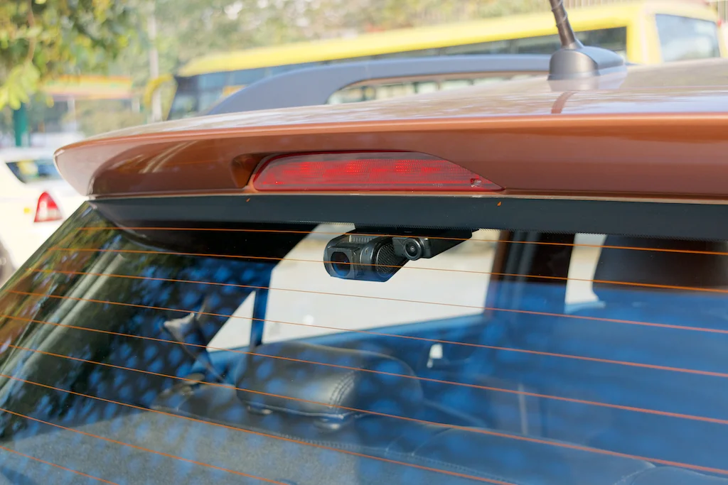

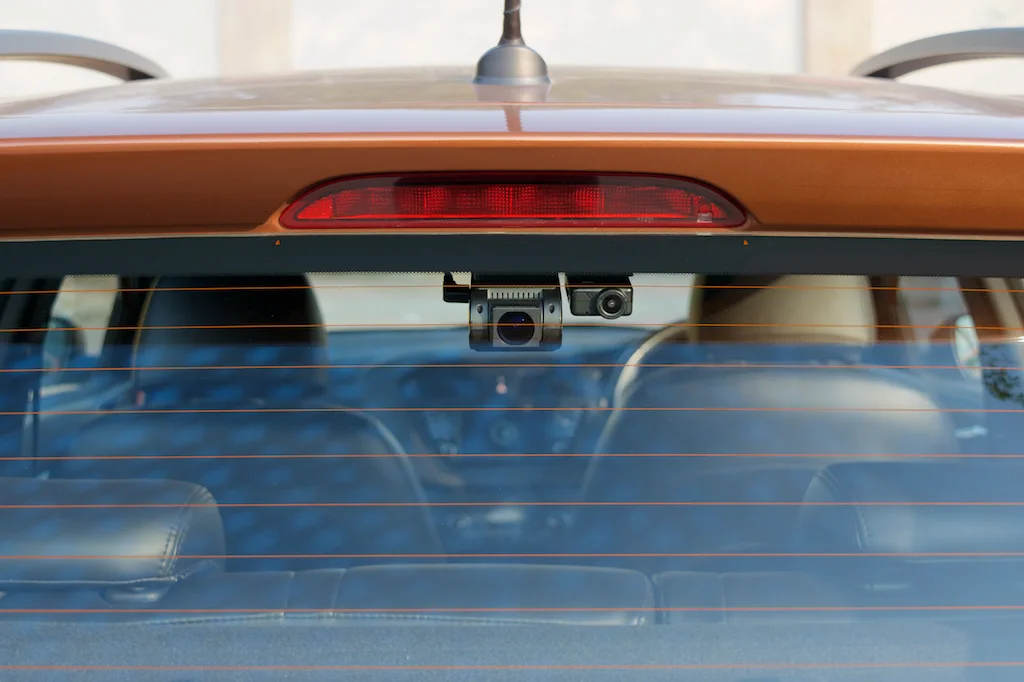

Fairly discreet as a rear camera too, obviously depends on how and where it’s mounted. I was quite apprehensive about the camera being visible through the rear windshield, not as noticeable as I’d initially thought. On reviewing footage I’ve noticed a few people looking at the camera but nothing more than a glance. With mostly just the lens visible to the passing eye, probably looks like an unconventional reversing-camera mounted behind the windscreen.
A119S and Mobius 2

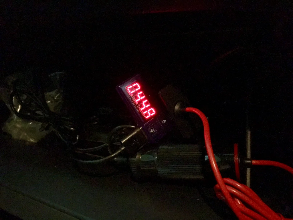

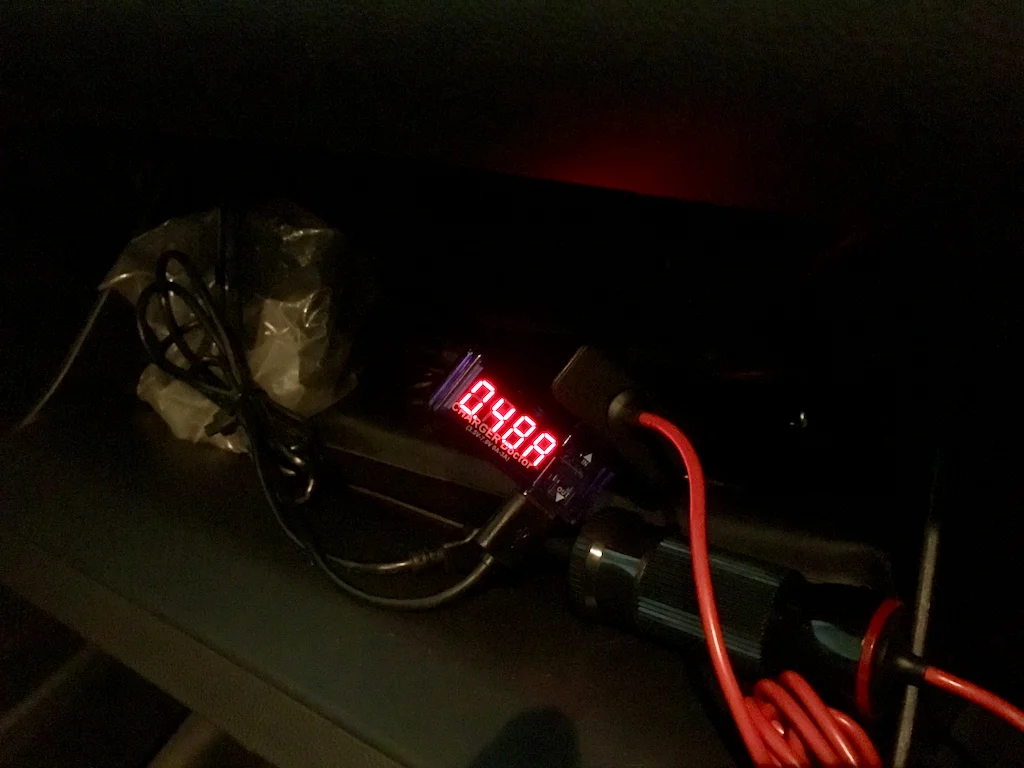

Did you compare power demand btw A119 and A119S?

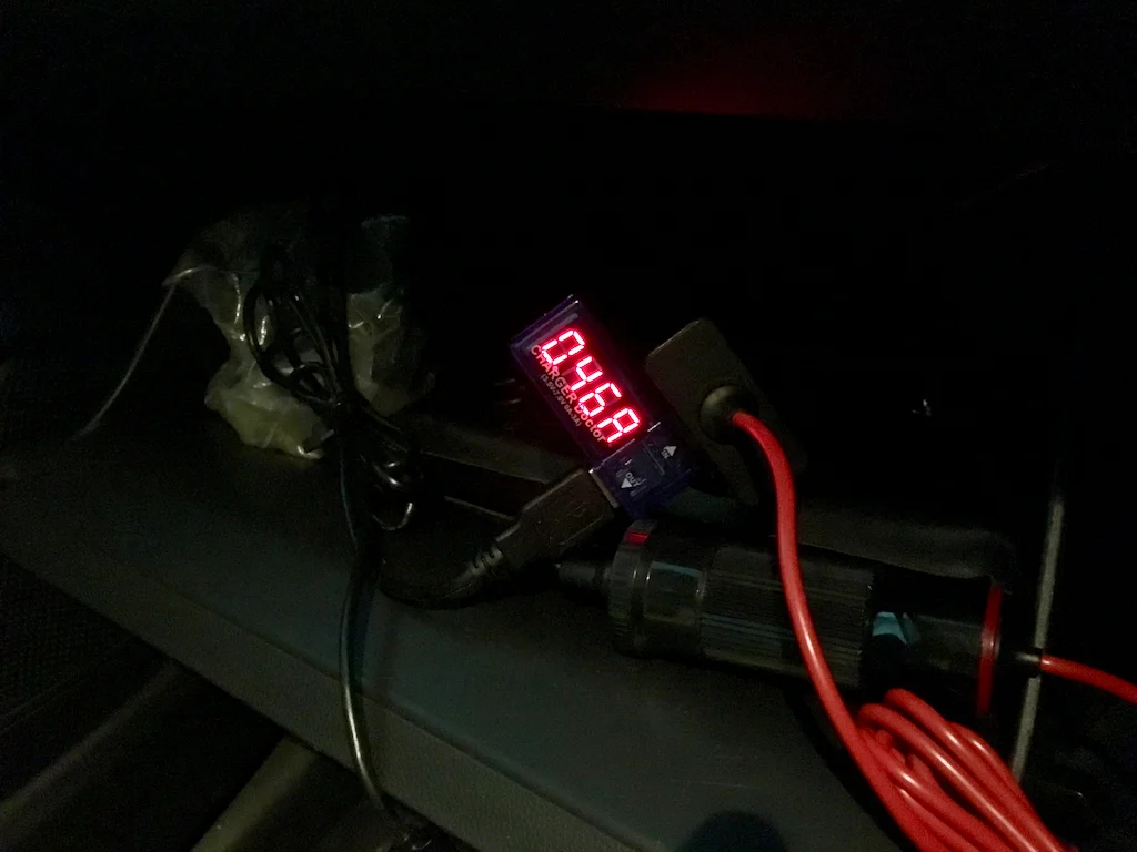

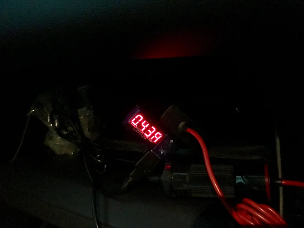

Edit: got the pictures mixed up
A119S after 90 seconds with the screen off
Screen turned back on
A119 after 90 seconds with the screen off
Difference between both cameras with the screen on and off is negligible.
