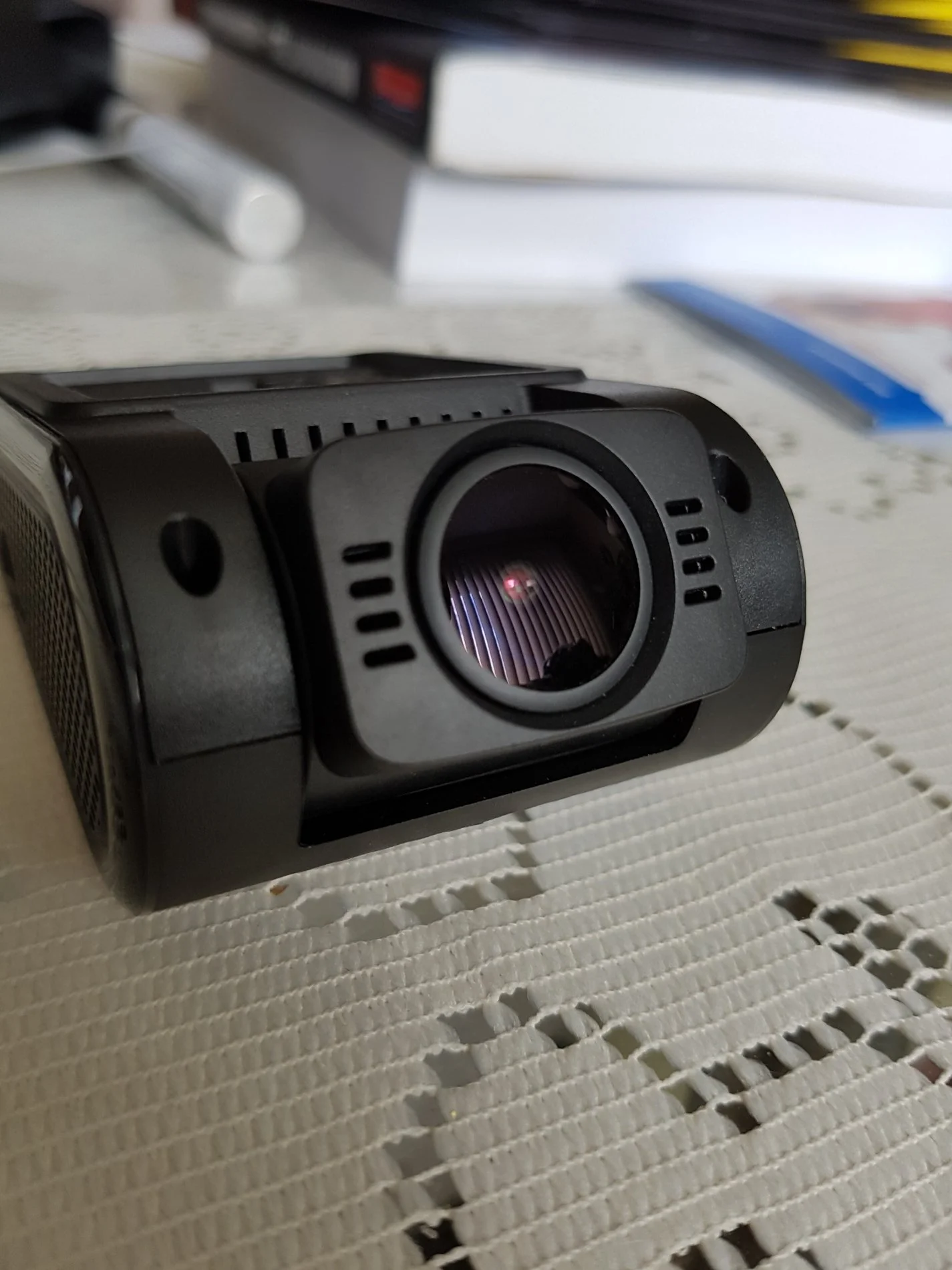

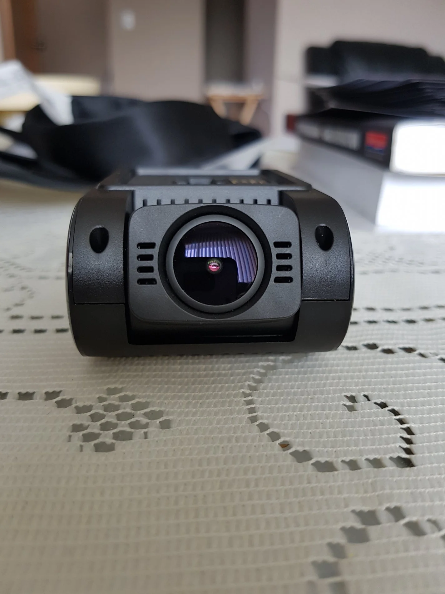

Is there a way to physically/visually tell the difference between V1/2/3 of the lenses used in the A119S?
I got two SpyTec A119S's from amazon last week. I'm thinking of picking up a CPL filter, but I hear there are issues with the filter and the newest lens used in the A119S.
Yes, share a pic.
Both of my cameras have this same lens, so I just took pictures of one of them.
Well I decided to open one of the cameras up and was following some of the tips from BC Hobbyist's video and I noticed some internal differences.
First I had to detach the speaker as that white tab was pointing down and the wires were coming out of the top and under the capacitors and camera ribbon. So I flipped it and cleaned up the wiring.
Second, my capacitors appear to be different. Mine are brown and not green. They say Cap Hy 2.7V 3.3F, whereas the green ones say Nano Force F9A. Not sure if there is a difference between the two.
Third, the camera module ribbon has been taped into a single strip. I guess for extra protection from heat and getting caught on anything?
Edit: Thanks Harsh. I guess I should hold off on buying the CPL filters until an updated one is released for the V3 A119S? Or would the A129 CPL filter work?
