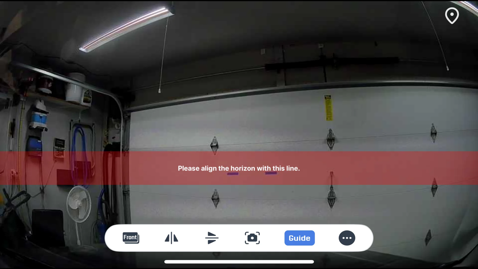

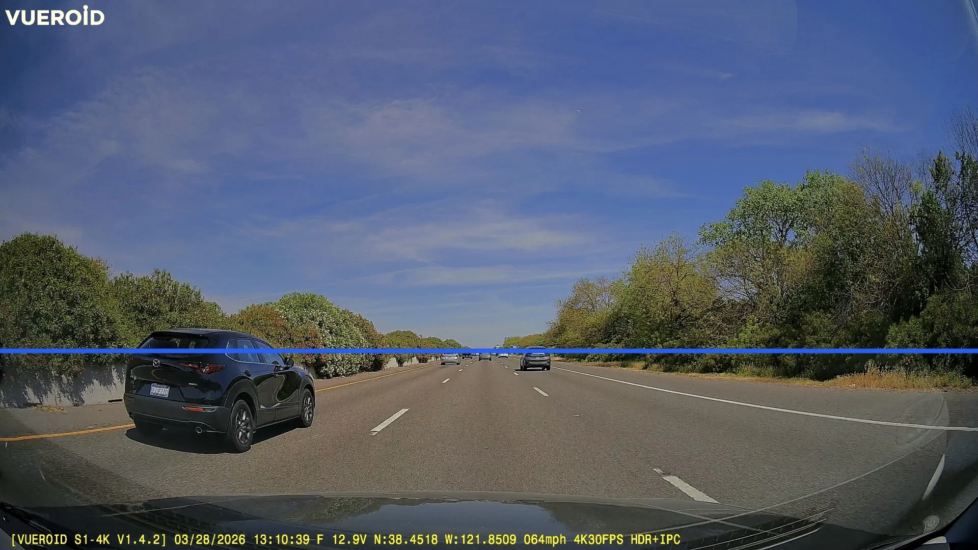

Random Test Footage (Firmware v1.4.2)
At the request of you know who, I gathered DAYTIME test footage with Vueroid’s new Horizon Line Adjustment recommendation offered in VueroidHUB APP.
The new recommendation is approximately 40% Road / 60% Sky.
For comparison I’ve got Viofo A329S Front, (50% Road & 50% Sky), and the Viofo Telephoto.
Check out the GPS Coordinates & Time on both screenshots.
Jack Trotter III Esq. would say; IDENTICAL!
CAMERA SETTINGS:
S1-4K
Firmware: v.1.4.2
Resolution: 4K30fps
HDR + IPC: Who knows? I can’t be trusted 😔
Bitrate: HIGH (highest setting)
1 Minute File Size: 394MB
CPL Filter: Yes
SD Card: 512GB Vueroid
Power Source: Vueroid 12V Hardwire Cable

I find it difficult to understand the comparison of footage between HDR+IPC Mode and Normal (Linear) Mode in daytime conditions. I also still believe that Normal Mode is the recommended setting during the day. That is why we recently implemented the Timed IPC mode.
Under sufficient daylight conditions, the strengths of Normal (Linear) Mode cannot be matched by any HDR. Of course, backlighting or reflections that may occasionally occur can be a drawback.
