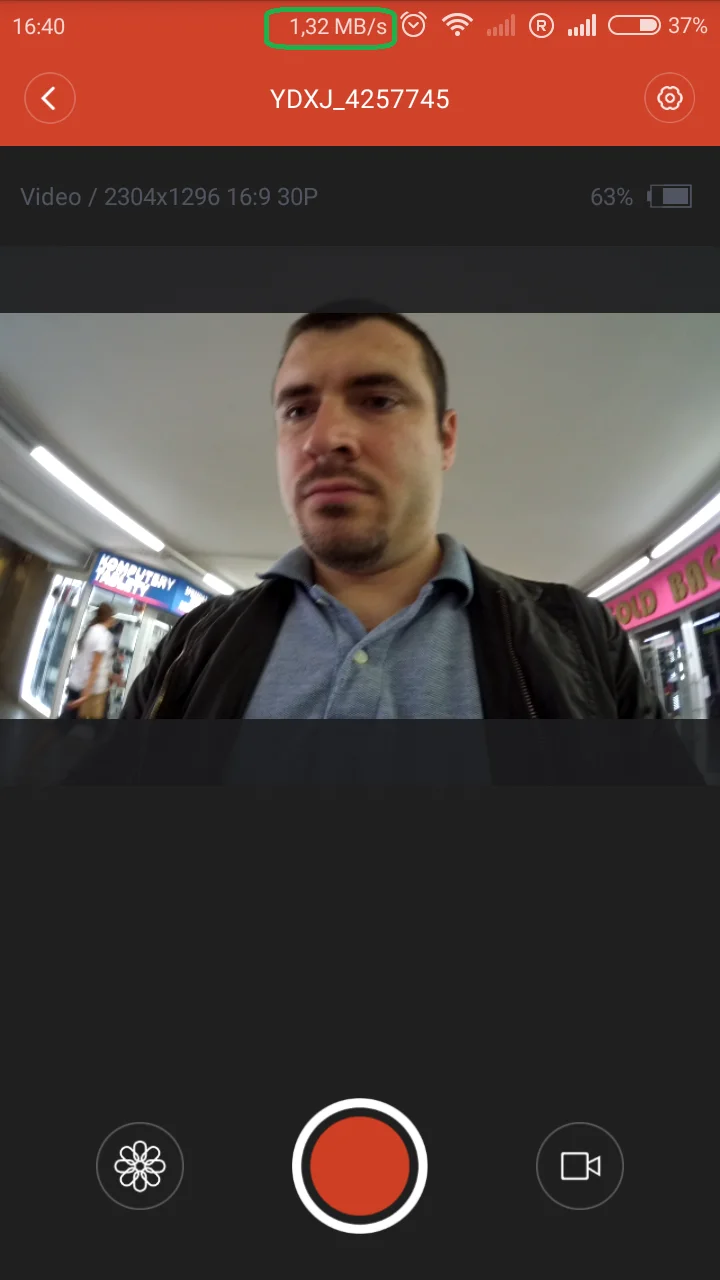

Hey @cpurage, first of all thx 4 the custom firmware. I made a little test today and got the same results with the bitrates and file splittings...The resolution was set to 2k, and after the split the second file was at just ~28 Mbit and ~ 1 minute. So, after then I set it to 1080p@60fps, and as you can see it at the attached jpg, the first file was YDXJ1074.mp4 with a 13 sec duration, but at ~43 Mbit. The second file is YDXJ1075.mp4 at ~28 Mbit, but it is a 2 GB file...and so on...BUT and this is important, files were missing during a continuous recording. It is about a ~ 15 mins disappeared 1080p@60 fps footage...The creation times are irrelevant and non exact (!), because my ride was ~ 15 mins long between YDXJ1076.mp4 and YDXJ1078.mp4, but the duration is just 6:30 mins...One more odd problem: just look the files YDXJ1080.mp4 and YDXJ1081.mp4 and the bitrates and durations, the record was continuous of course...Same results with the battery in-out cheat πŸ™‚
I hope these details will help you and other custom firmware coders πŸ™‚
Any idea?

DAMN so it is a stupid bug of the App, once connected and once the video is trigerred through the phone there will be video which will be splitted 1st Video (short) @50Mbps and there will be second on @30-35Mbps πŸ™ no matter are you going to use the ash script with all the selectable resolutions inside it or you are going to use the custom firmware πŸ™ and if there is no high bit rate, there is no video split even if connected with the app and shooting and previewing in the same time. The only work around as I already said is removing the battery and start shooting the video after the first boot, this is curently the only way the 1296p/1080p @ 50Mbps to remain in one whole file !!!
ALSO there was something that I've saw and I was pleased to see it πŸ˜€, with my ASH script:
Nothing touched on the firmware, only the ASH script from my previous posts, so probably somthing is speeding up too much πŸ˜€ so now I'll test to see if the preview mode on the VLS with CC.exe is faster, wish me luck.
It change preview mode value without touch it??... Anyway good luck for vlc try... πŸ˜‰
Yes it changed it on the phone App, but no success with the VLC same speed πŸ™

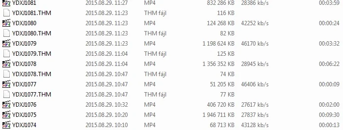

I really don't get it ??? So I'll explain what I did so far and it WORKS on 100% and I got one 1.85GB File @ 50Mbps Bitrate and another one smaller but again @ 50Mbps Bitrate. I know that it will be boring to some of you but IT WORKS:
1) Factory Reset of the Camera
2) Set the Video mode default after boot and resolution you want through App WITHOUT MicroSD in the camera
3) Format your MicroSD on your Laptop/PC FAT32 fast format and put the battery in the Camera
4) Boot the camera and start recording
Worked for me in 1080p@60FPS and 1296p@30FPS both on 50Mbps
Check the attached screenshots
Once the app is connected and the Video is triggered by the App, there is a splittage and first file is 50Mbps and the rest files are 30Mbps ???
