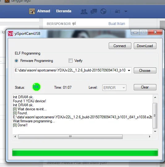

is this success update firmware???
please check my screenshot
