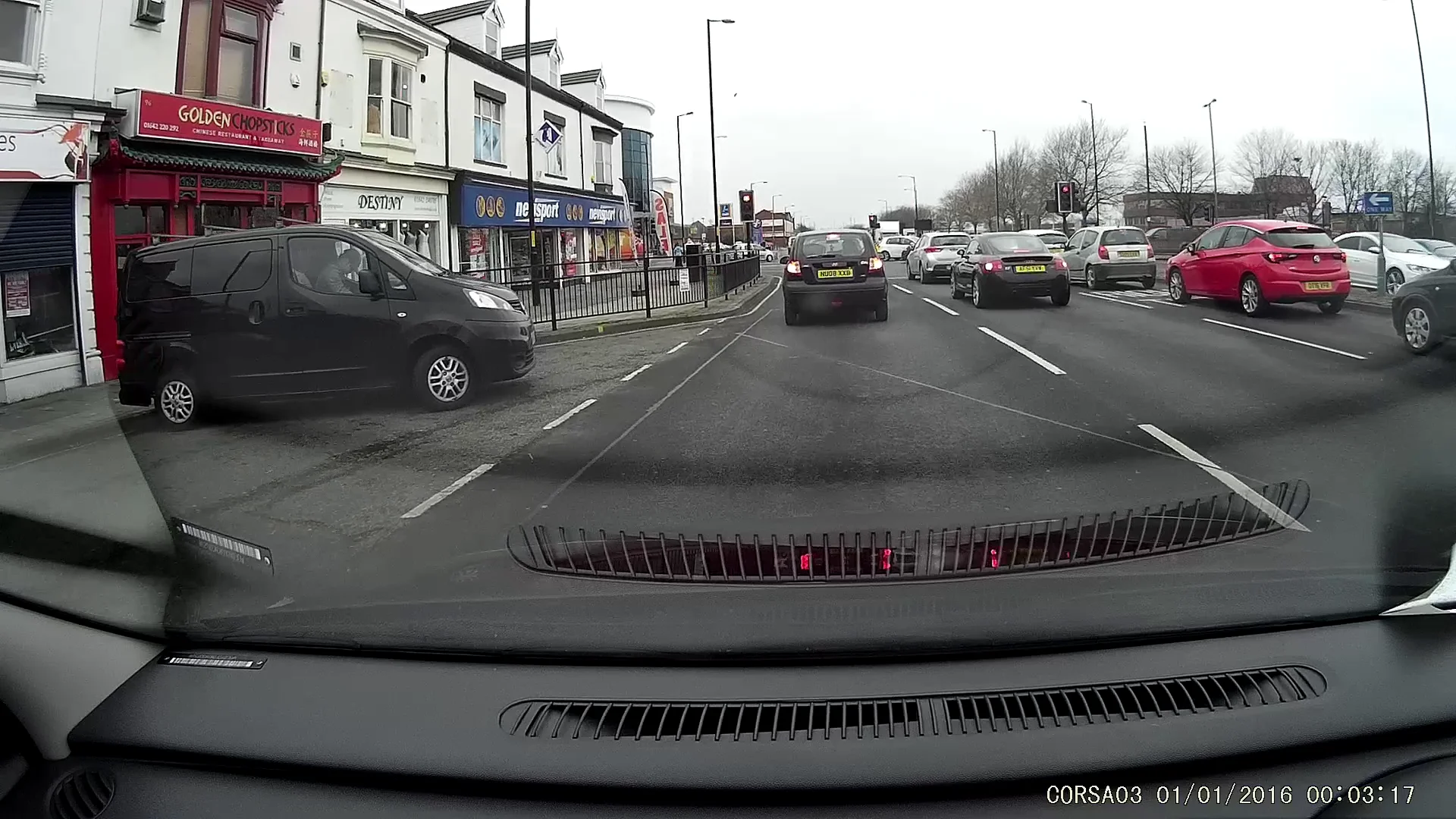

Just got my auto-vox version through the link to amazon on this website. I'm very happy with it but the date and time resets every time it is turned off.
if it's out by a couple of hours by a fixed amount it might be a timezone setting if you are using with GPS, if it's resetting to some default date like 01/01/2016 or similar it's faulty, send it back
Edit: just looked at your screenshot, camera is faulty
