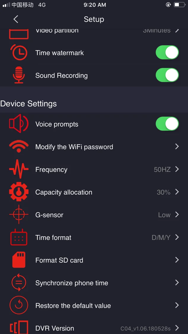

Thanks. That was my problem. I updated to 1.7.7 and it has the option. New problem though. 1.7.7 is not in English in the settings area.
Please show me your APP interface, so I can have a check, thanks!
