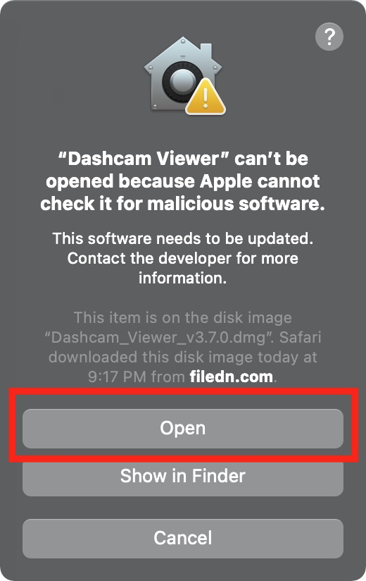

I used the built in update check to downloaded v3.7.0 for macOS 11.6. After unpacking the DMG and overwriting the existing application package folder, I encountered this message when trying to open it.
“Dashcam Viewer.app” can’t be opened because Apple cannot check it for malicious software.
This software needs to be updated. Contact the developer for more information.
I subsequently deleted the installed application folder, then attempted again to unpack and place the application back into the Applications folder, but once more encountered the same failure and message.

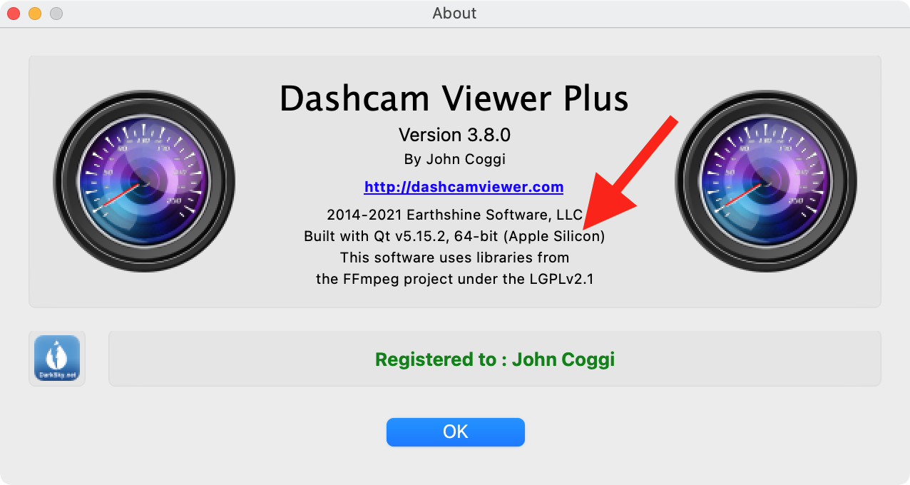

  • [macOS] Dashcam Viewer is now available in both native Intel and Apple Silicon (e.g., M1) builds. Due to the ginormous size of Dashcam Viewer, a combined universal binary version is not practical. Instead, simply download the appropriate version for the Mac’s CPU architecture. This is our first Apple Silicon version so please PM me with any odd behavior (beyond the normal odd behavior). And remember you can always run the Intel version on an M1 Mac (it emulated but still very fast).
Going native on MacBook Air M1
The first time you run Dashcam Viewer on macOS, you may get a warning that Apple cannot check it for malicious software. To get around this, right-click on the Dashcam Viewer icon and select Open from the pop-up menu. Then you'll see the warning dialog again but this time there will be an Open button you can select.
