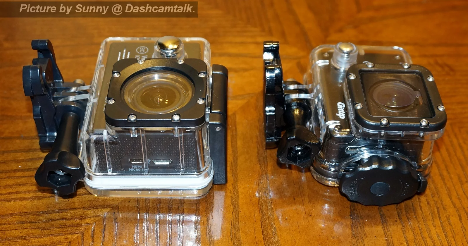

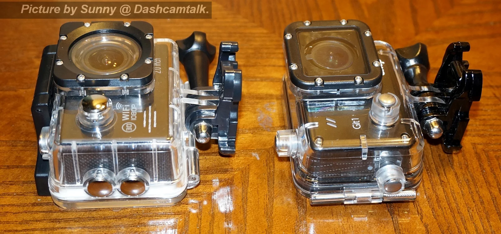

Git1 in waterproof housing side-by-side with SJ7000:
Housing is also of good quality.
Opens from side with a twist.
continued...

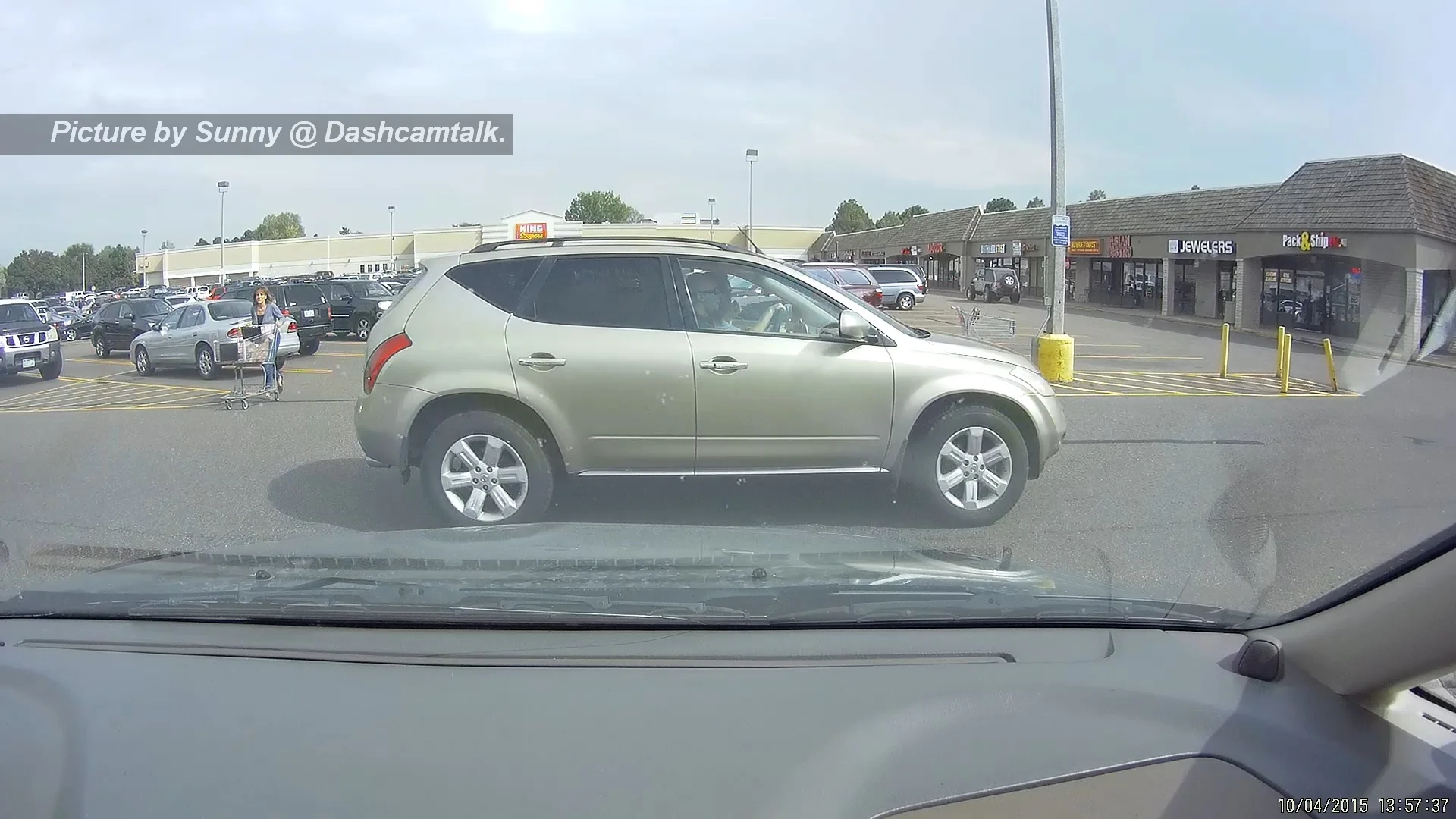

Daytime screenshots:
Today is cloudy as well but there were few times with sunshine.
Video quality is very good.
All areas, including corners are in excellent focus and sharp.
continued...
Daytime screenshots continued...
Lots of dashboard reflection against the sunlight which is hard to fix without CPL filter.

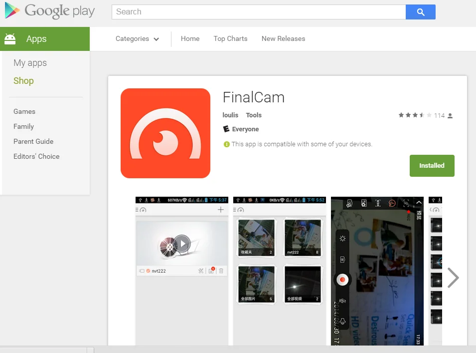

Wi-Fi app and connection for Git1:
To connect the Git1 via Wi-Fi, press and hold the settings button for few seconds until it chimes few times and shows wi-fi is on
Then, you need an app to connect to the wi-fi access point.
The manual didn't mention what app to use so i searched and found FinalCam works so downloaded it and installed.
Open the app and click on + to add camera:
Click on the GITUP**** access point, enter password and click 'Add':
Once connected, you'll see live view of the camera:
There are a lot of features on this app to change settings of the camera.
The top left looks like motion detection and the one below that looks like time laps but not sure.
@gitup , do you know what they are?
Other settings on the left are for photo and video mode.
On the right, there is an icon to show battery level and other icons below that to access saved clips for playback and download.
There is a camera settings icon on the bottom right.
In the center bottom bar, there are icons for exposure(or awb, need to confirm), photo, video record, mic and volume.
The camera setting icon on the bottom right allows changing various camera features like camera wi-fi name, password, video quality, including formatting the card:

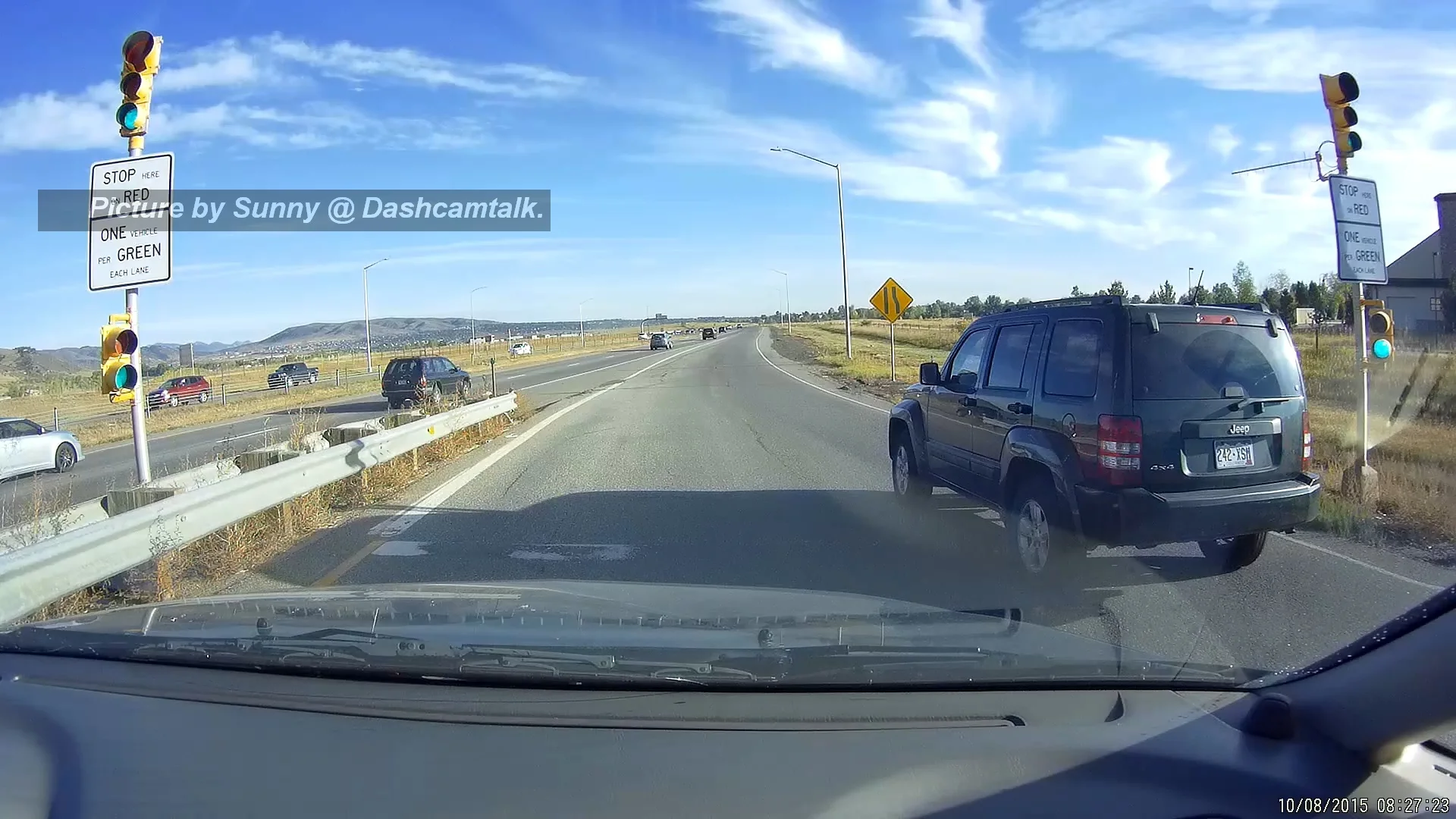

Okay this Git1 is growing on me. Few more daytime screenshots from video:
Signboards on both sides are very sharp and clear and mountains far away are also in great focus:
Same here:
Overexposed sky due to shadows from buildings but very good video of the streets/vehicles:
This is right after the above screenshot and it quickly adjusts Sky's exposure when there is sunlight:

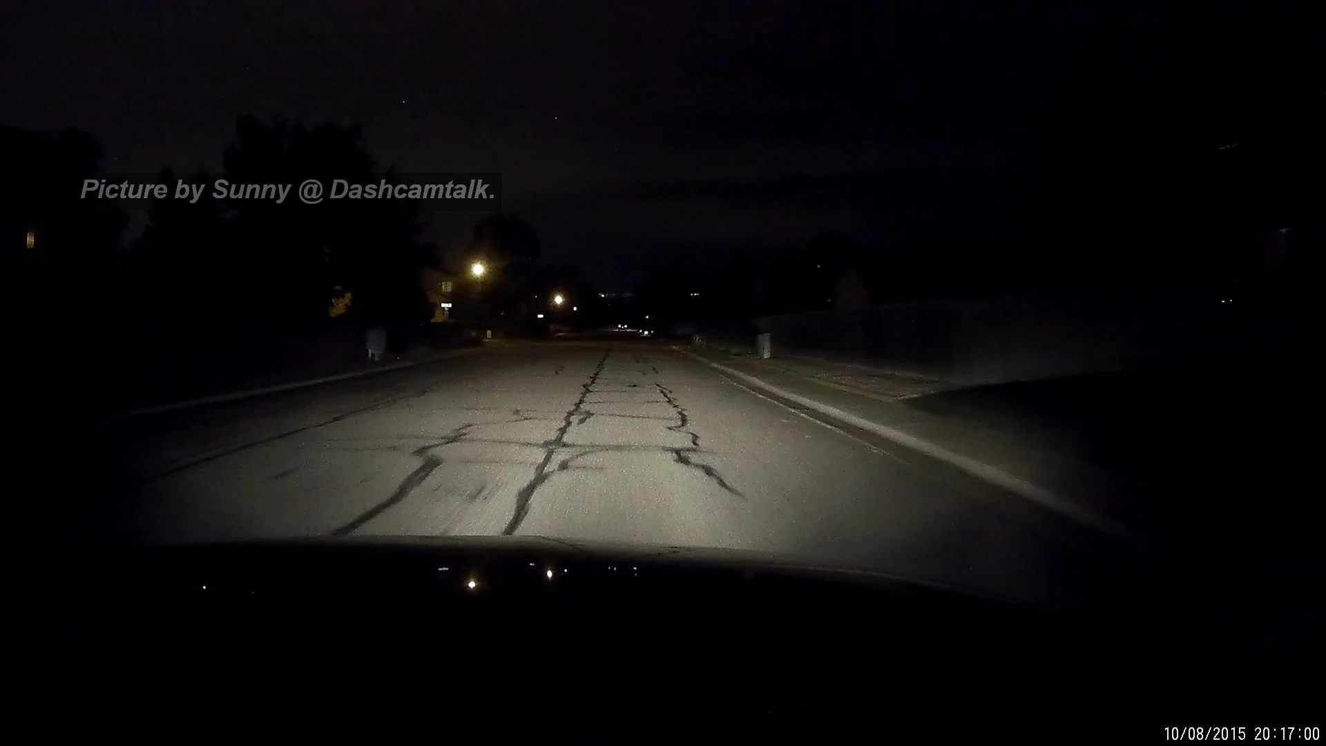

Low light and Night screenshots:
The Sony IMX322 sensor in Git1 is very good in low light/night.
Git1 probably has the best night video among all my dashcams.
Need to compare the Git1 against Lukas that uses same sensor to see which ones better but Git1's night performance is very nice and I guess it'll be better due to higher VBR.

Overall, Gitup Git1 has excellent low light/night performance.
I was surprised by it too. When I was doing the battery life test, someone turned off the lights in the room, but sunlight coming in through a window in the next room (around the corner, and no windows in my office where the camera was) was more than enough to still clearly make out the digital clock I had the camera pointed at.
