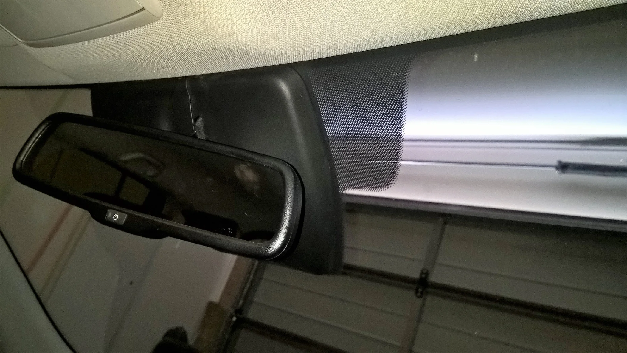

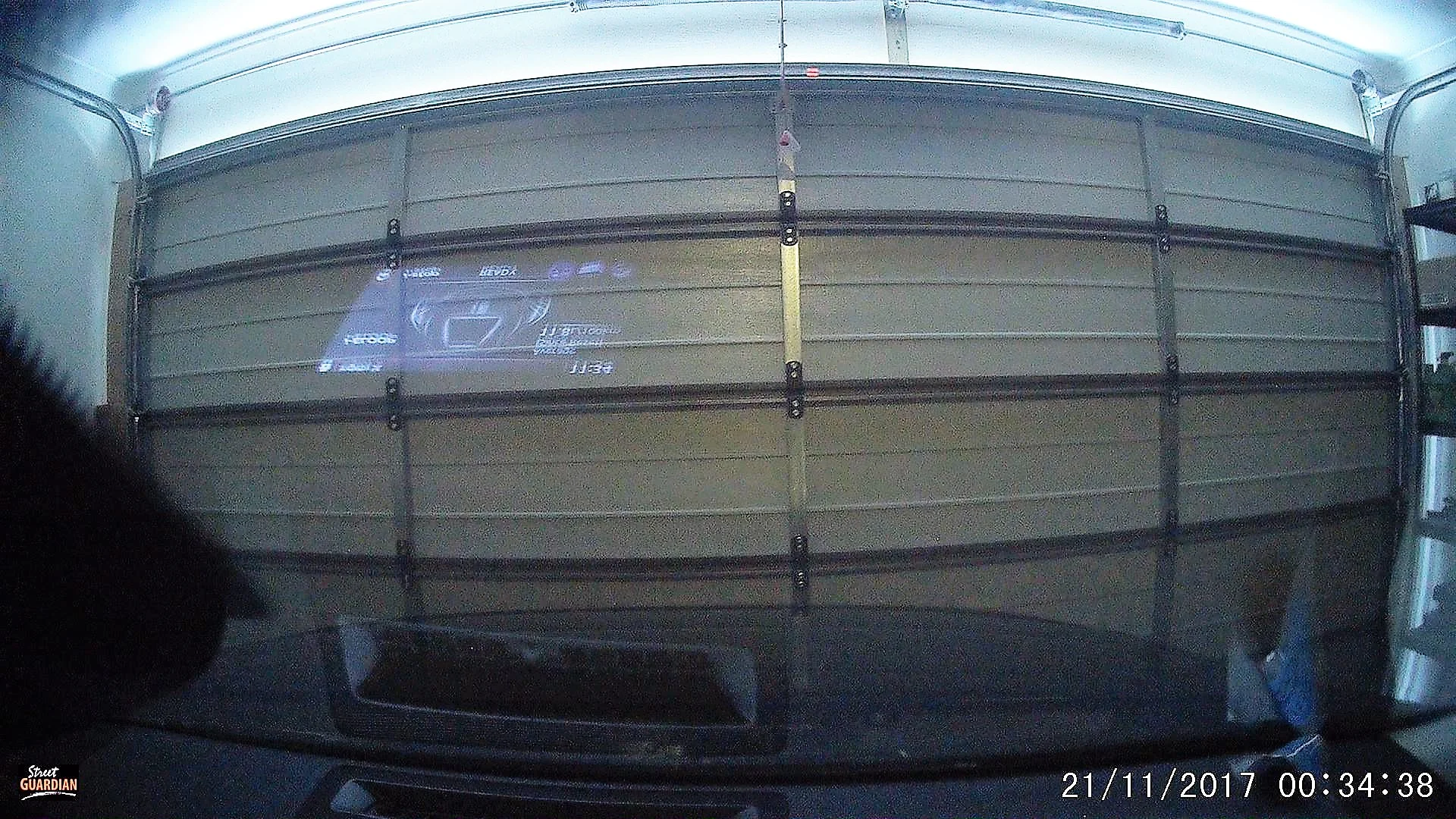

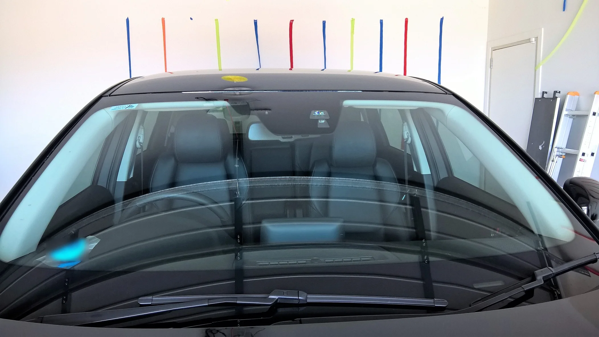

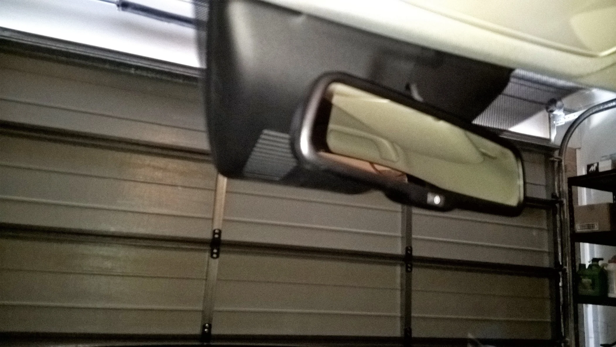

As expected, I am having trouble positioning the front cam. If I place it on the frit on the driver side, the sensor cluster comes into the view as well. If I position it further down it will be clearly visible from the front, and I am afraid it may obstruct my vision. Same issue (and no frit either) on the passenger side. I have added some pictures to show what I mean.

I am considering sticking the camera to the underside of the sensor cluster. Would that be an issue considering it is plastic?

gee that thing is massive, i havent ever seen one that big before.
possible half of it is empty and they just extended it for the looks, can you mount the camera inside of it or cut a bit out of it?
Yes, it is massive. They have done a good job hiding it behind the rearview mirror so I don't see the bulkiness when driving. Like you say, it is likely mostly hollow, but not keen to mess with it.

Thanks. I thought about and hence this question, so from your picture I take it that it is not an issue?
No problem for me. I did have a bit of an issue with the adhesion on the plastic. I originally used industrial strength Velcro (shown in the picture) but subsequently switched to 3M Dual-Lock. The dual lock would come loose after a period of time - possibly due to oils leeching out of the plastic or the surface texture, or both. Solved that by using the Dual-Lock and some dual sided mounting tape to provide some cushioning and better conformity with the housing texture - had no adhesion problems after that.
I recently sold that vehicle and was able to remove everything from the housing without any issues as well.
interesting. So, the double sided tape had better contact to the housing that dual-lock. Hmm.
Yes, most dual lock I've used had a semi rigid, almost solid rubber-like adhesive. And when placed directly on the glass in my car, the adhesive melted in the summer heat and slowly slid down the windshield till it eventually fell off.
Foam tape conforms to textured surfaces better than the stuff on dual lock.
