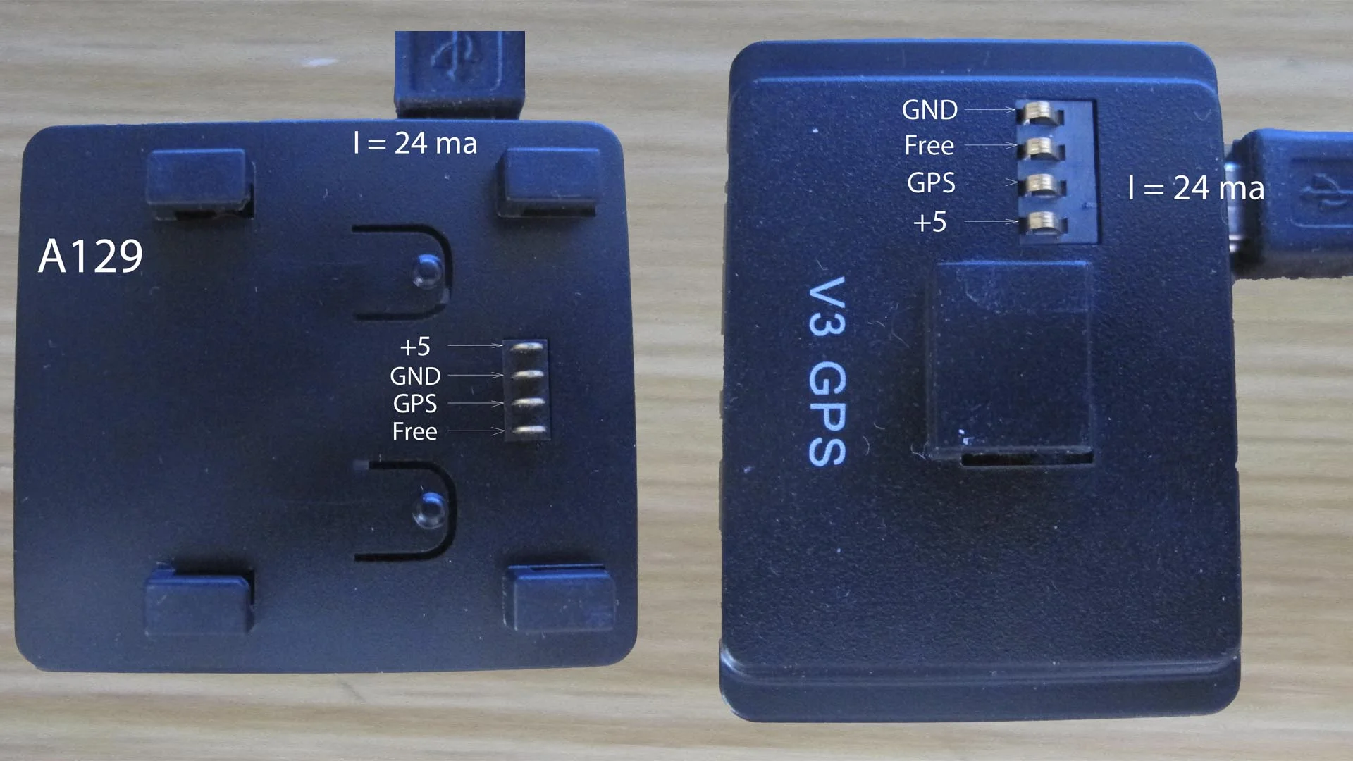

The cable has a free wire and in order not to pull a cable for the AV , you can neatly insert it as in the photo.
So the cable will be universal for Viofo DVR.
There is another way to connect an AV without any additional cable, but it is more complicated.
Different GPS modules.
great AV custom cable MOD idea for vehicles with LCD console media panels. Its always interesting to see pinout variations between models, they never stay the same.
Viofo could rewire the GPS module connectors for +5v / GPS / ACC / GND
+5v = Battery +
GPS = signal
ACC = ignition voltage signals for advanced parking mode support from 3-wire Hardwire Kit.
GND = Ground -
too bad the GPS module doesn't have 6 or 8 contact points for enhanced feature expansion.
