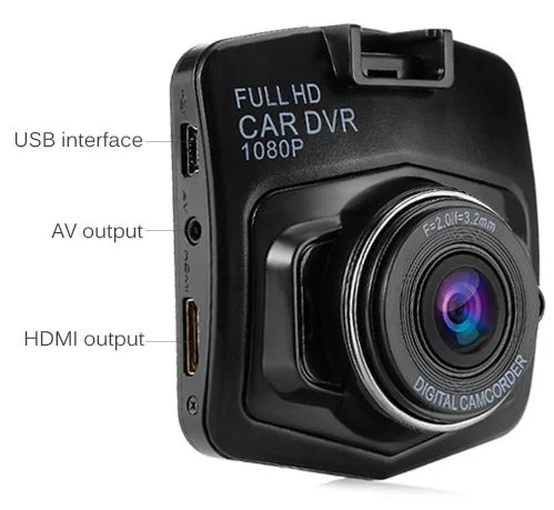

There's no room to add those, cheap dashcams have HDMI output as it's the cheapest way to manufacture and be able to adjust lens focus during assembly, it better suits the way the public models are sold to assembly factories

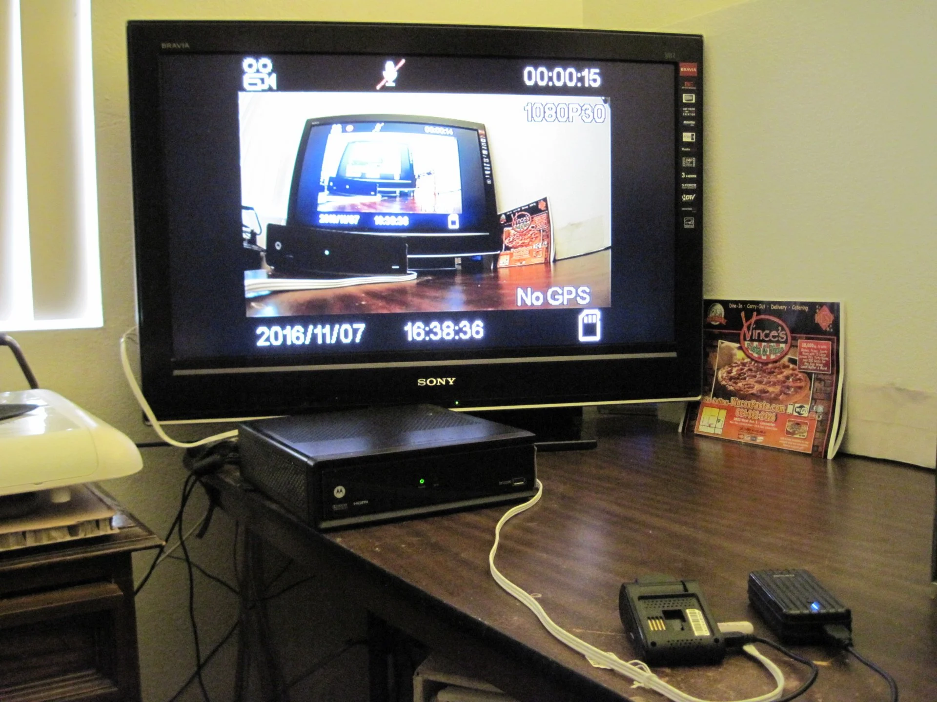

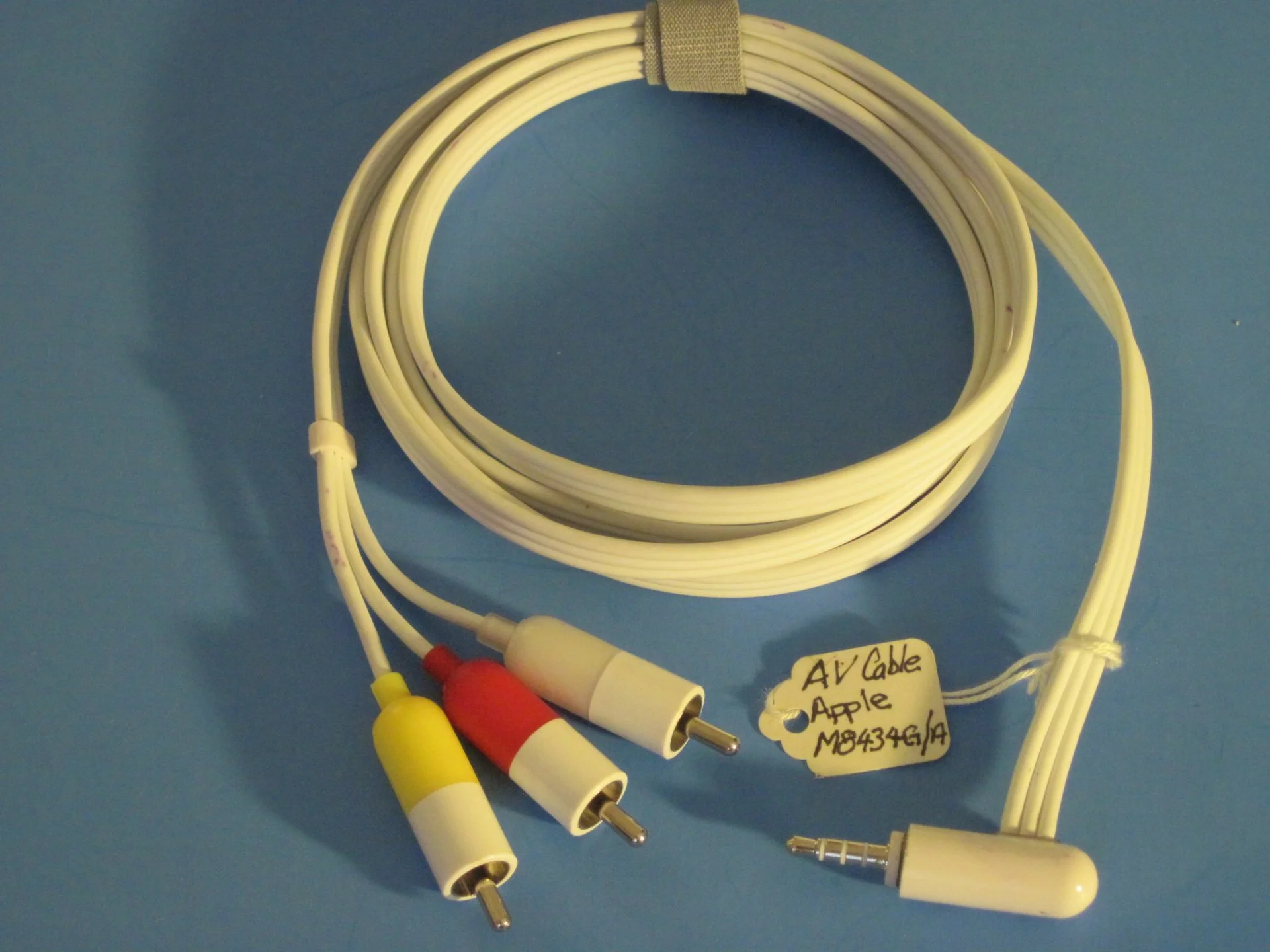

Presuming the A129 AV output is wired like the A119, the cable needed is a 4 pin 3.5 mm plug to 3 RCA plugs to connect to the video input RCA jacks on a TV. The Apple iBook AV cable pictured below is wired correctly but the backshell had to be modified to fit the depression around the A119 AV output jack. The video out is analog Standard Definition and the image is the same as that on the camera LCD display except for size, including the status overlay. See also this post and thread: https://dashcamtalk.com/forum/threads/video-cable.21275/#post-298099.

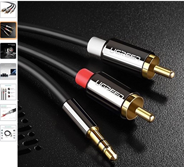

This cable works
https://www.amazon.com/gp/B00LM2Y2XG

Thanks. That's the thread I remember reading when I looked into AV-out on my A119 and A129 cameras.

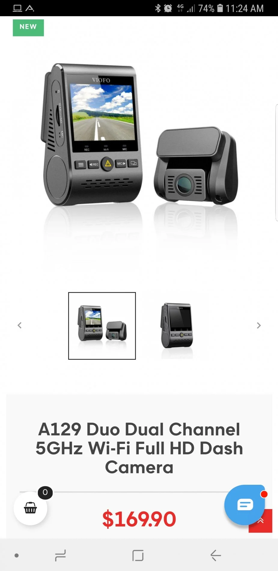

Definitely a nice price for the A129!
