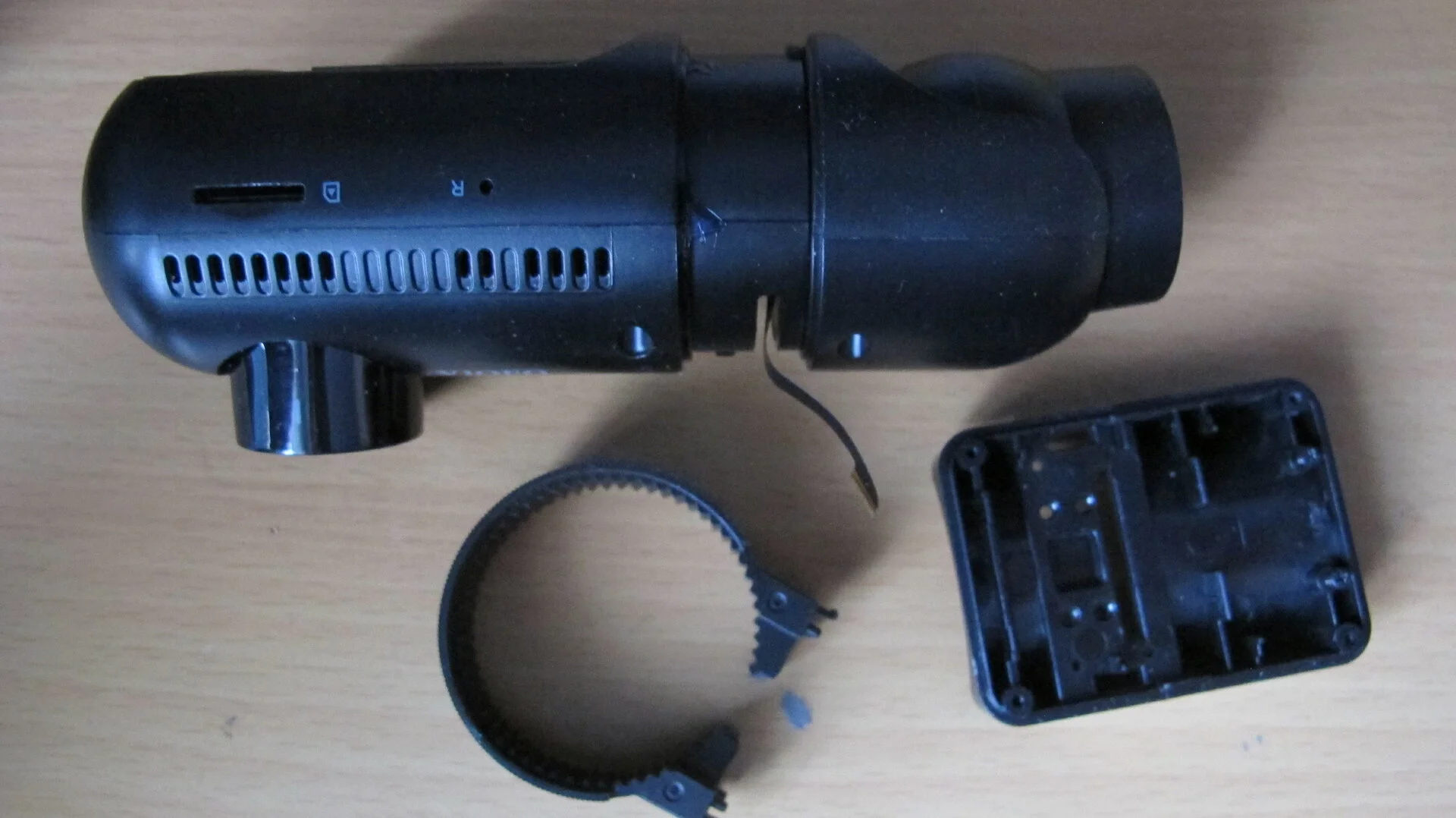

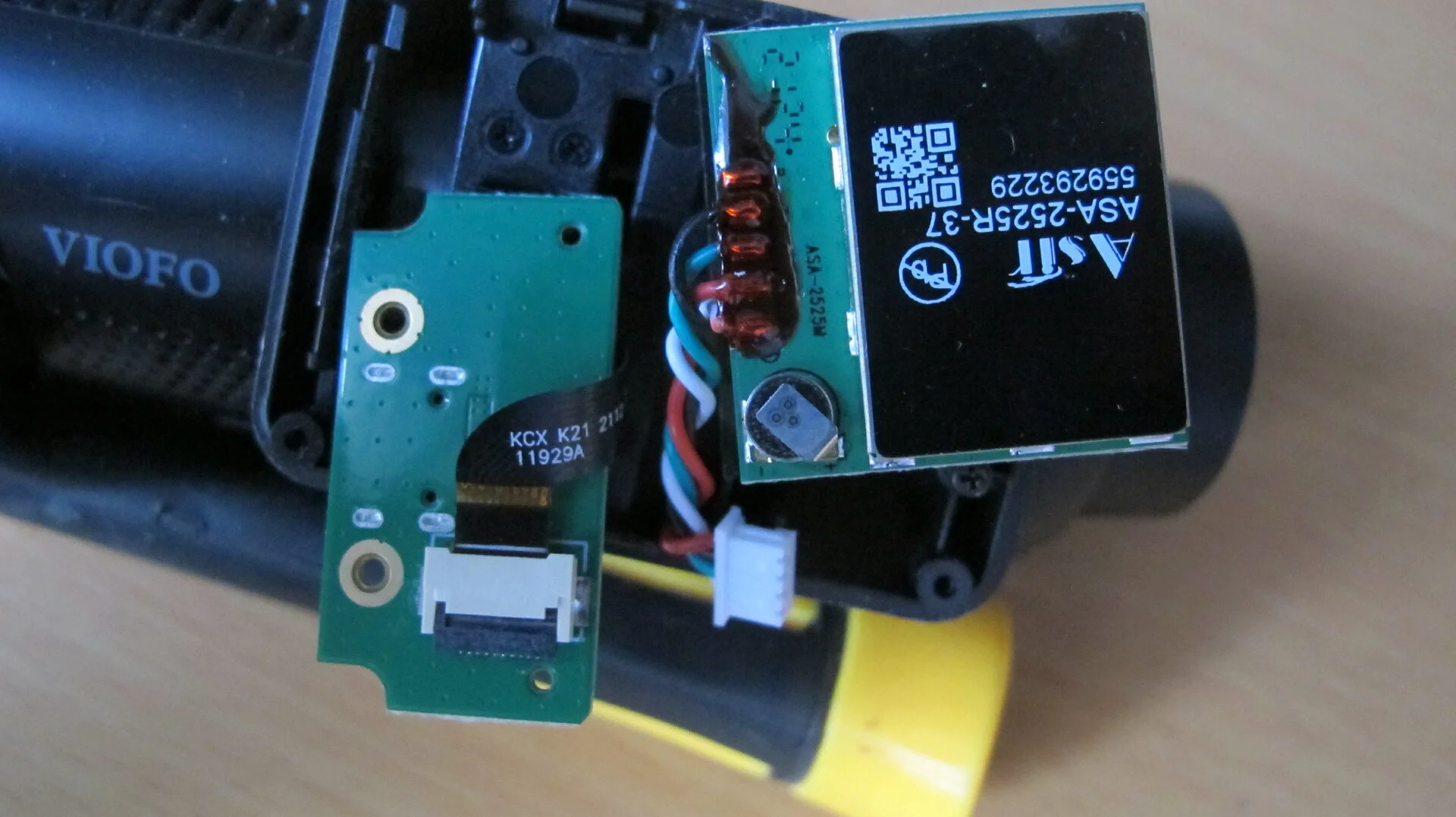

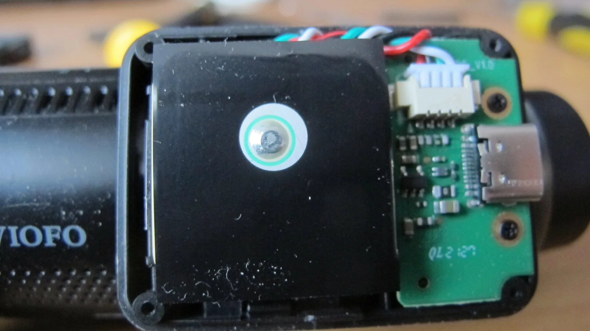

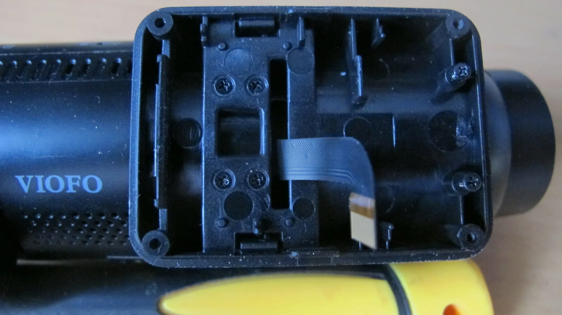

Partially disassembled to eliminate backlash !!
put a cloth tape and put it together, now there is no backlash and the ratchet works with an interference fit, that's what you need !!

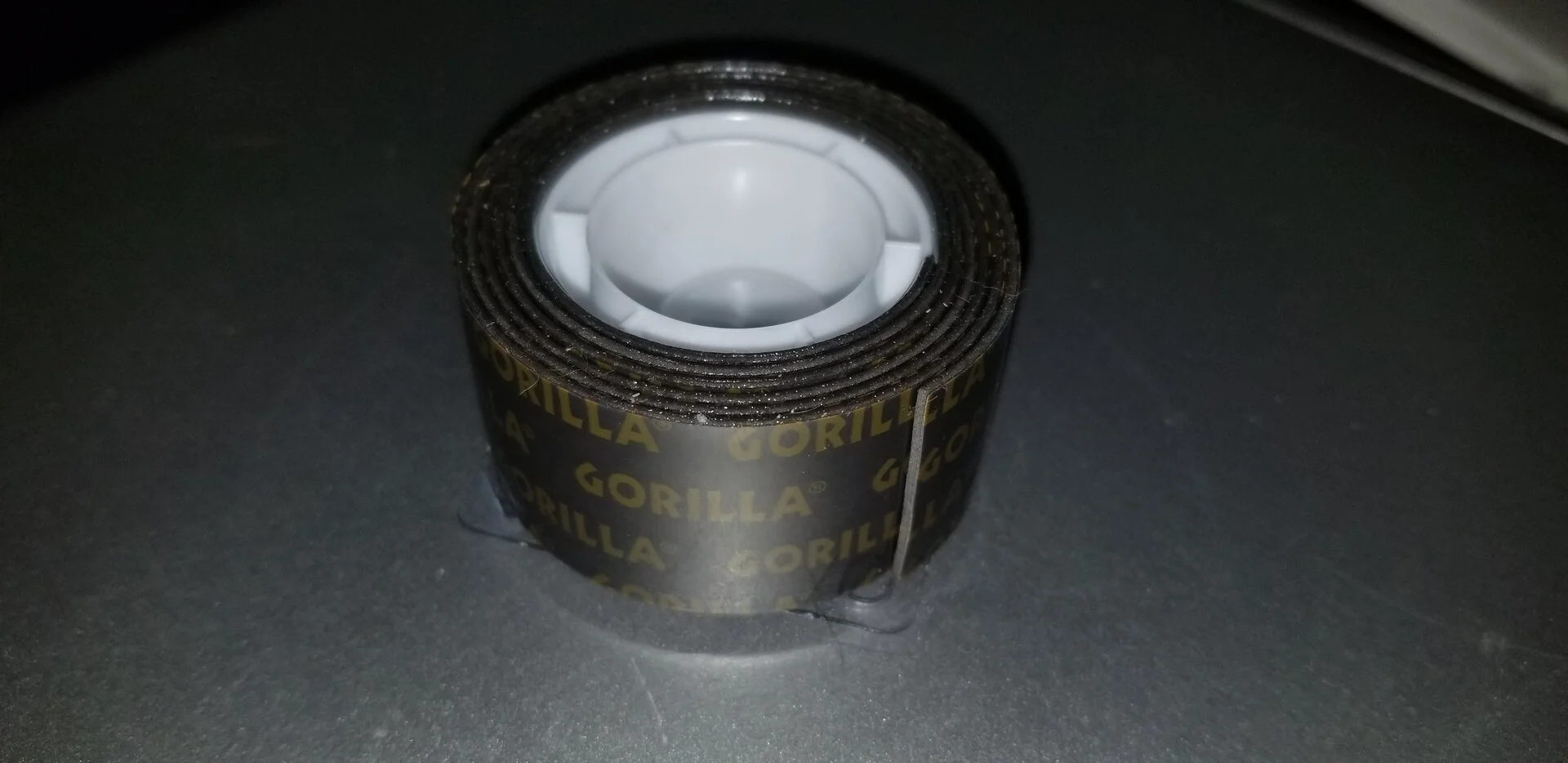

If you used the provided spare sticky pad like I did as well, it is going to fall again soon. Those pads didn't seem to have a name brand on them unlike the ones from the other viofo products where they where using the good 3M pads.
I have used the gorilla double sided tape (see picture) with great success recently and I recommend it but like I said before, there is no going wrong by using the 3M brand. In my opinion they seem equivalent in performance.
