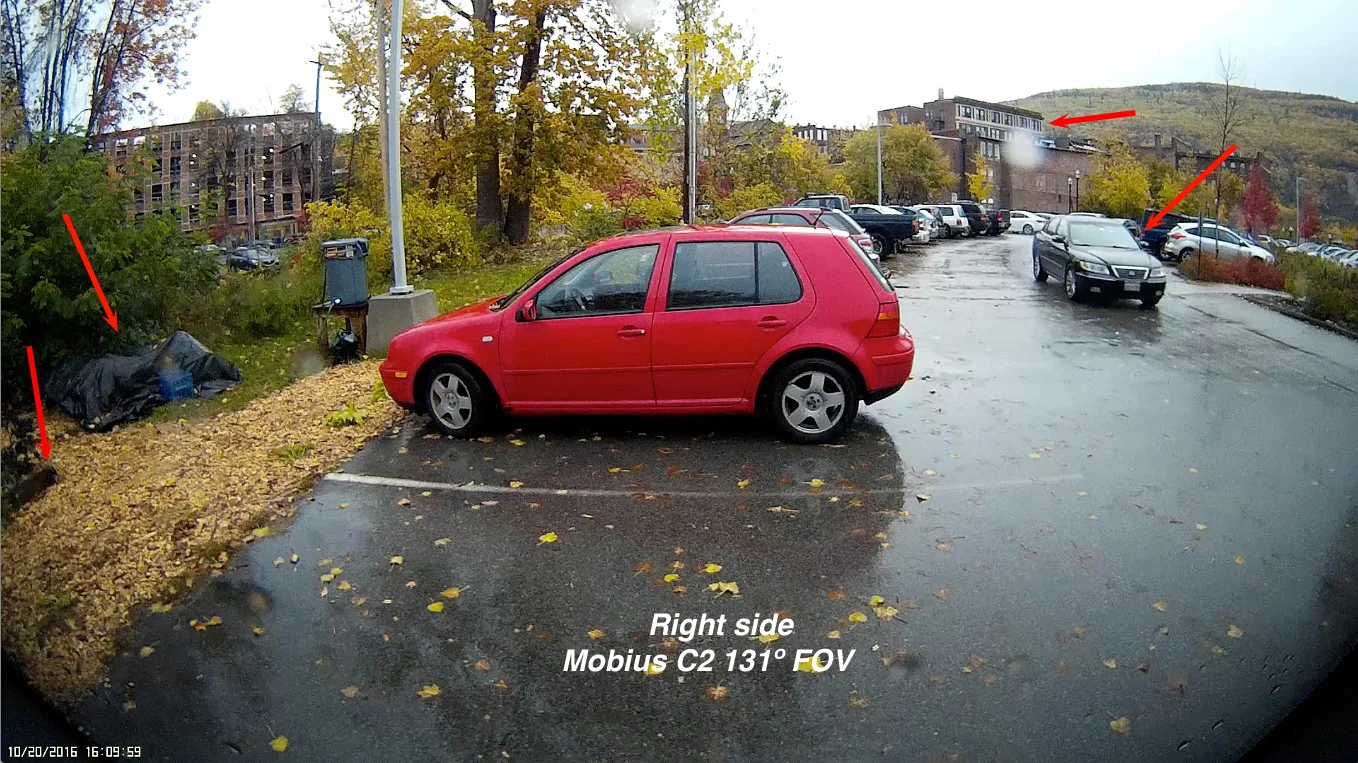

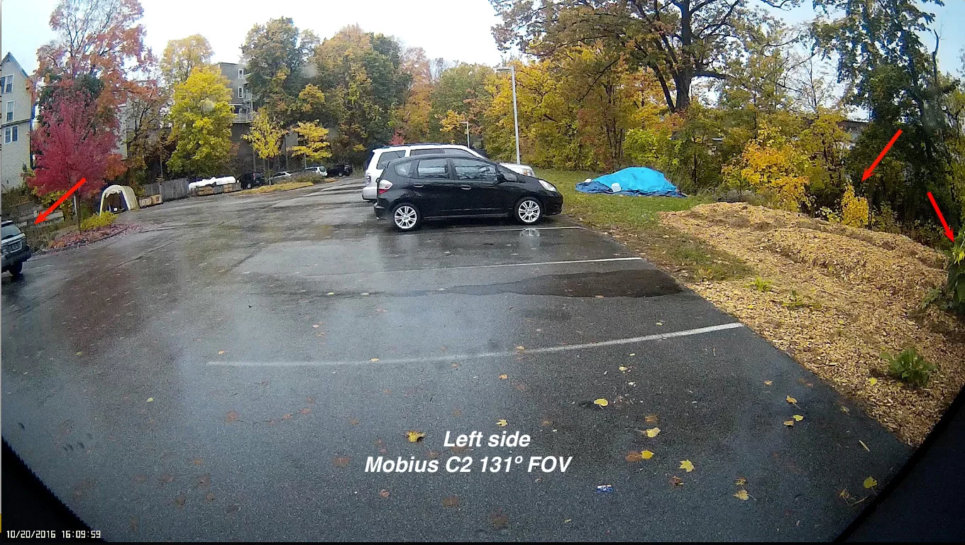

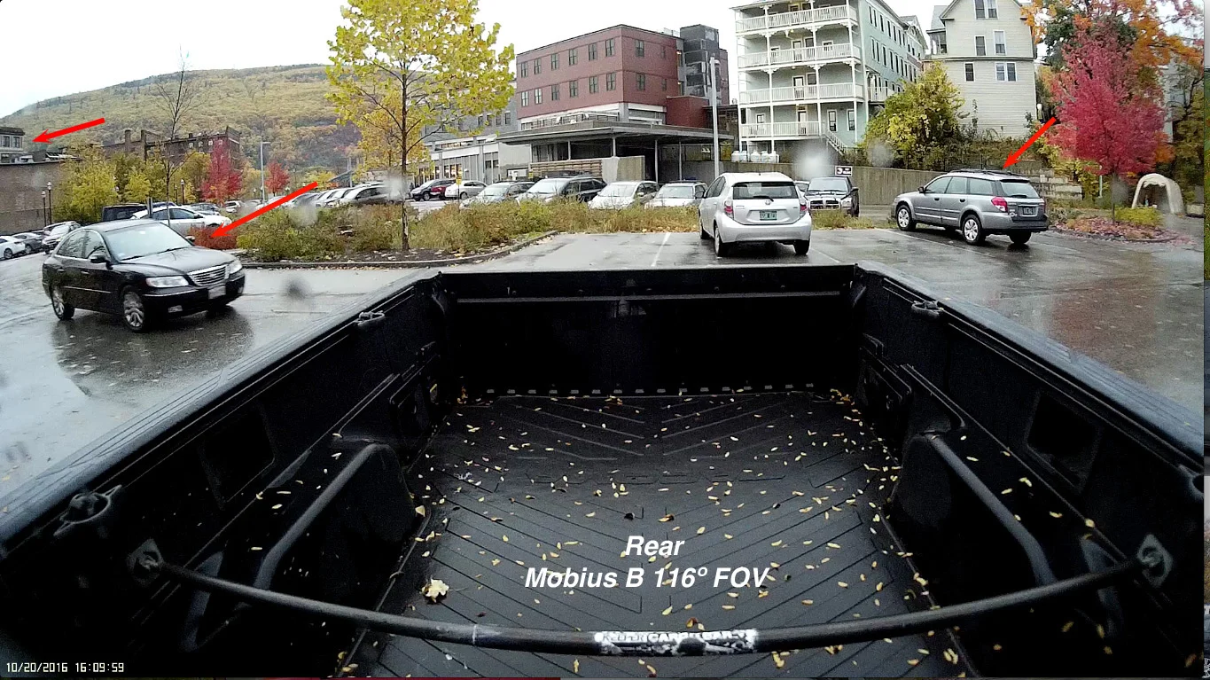

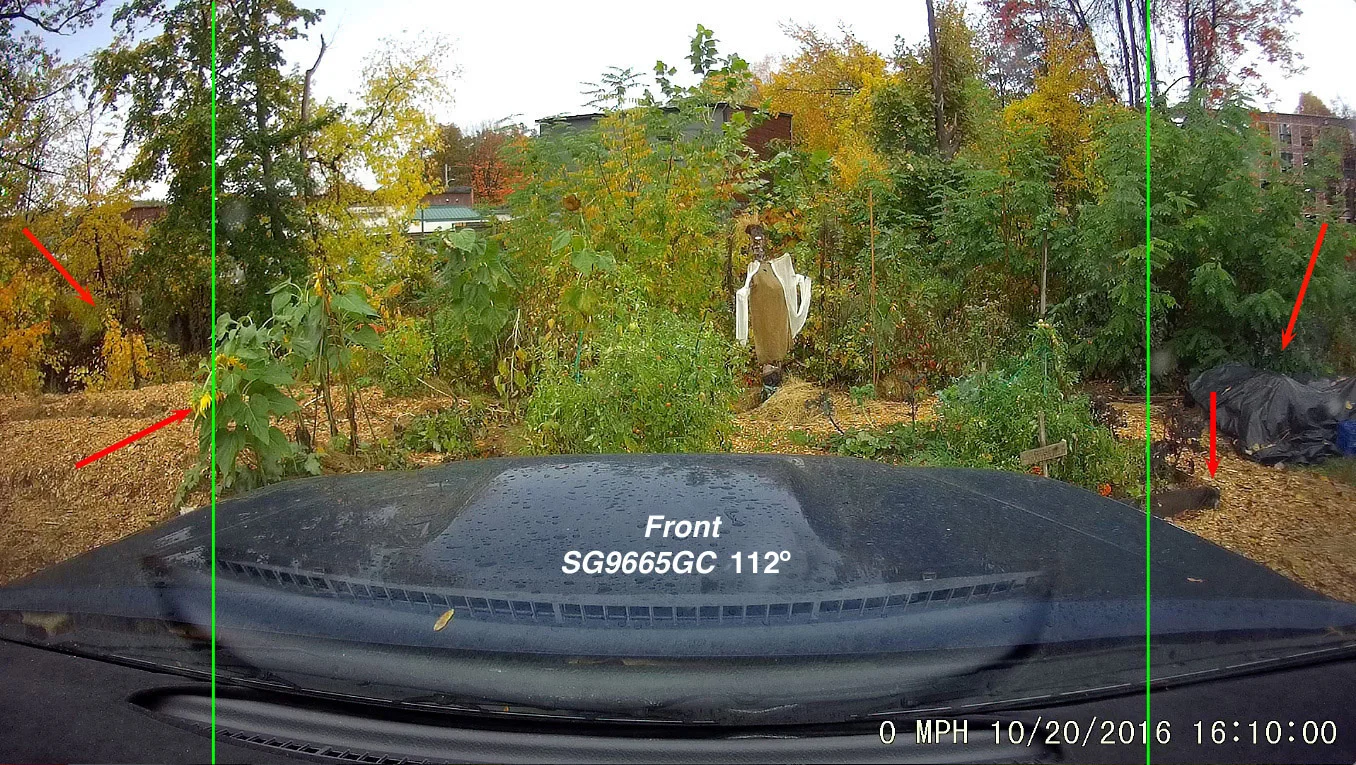

I've posted these screen grabs elsewhere here on DCT but since they seem to be germane to the discussion here is what my 360º coverage set-up looks like in a Toyota Tacoma after experimentation with various cameras and lens FOV options.
I've learned that having significant overlap from camera to camera is very important as is coverage as close in to the sides of your vehicle as possible. Only real world testing will tell you that. A graphic with drawn lines of theoretical coverage will not.
Nice installation sensibly done.
So, I got to thinking about my previous posting of these screen grabs with regard to the importance of having overlapping coverage from each camera if one should decide to do a four camera 360º installation. While the previous posting of the images certainly shows the concept I decided it might be interesting to pin down the exact point of each camera's overlapping coverage with it's abutting neighbor to each side rather than to just point out objects that can be seen in each of the successive images. It seems to make for a more enlightening method of presenting this.
So, here are the same images again but with a green line at the exact point in each image where the boundary of each adjoining camera's FOV overlaps the next on either side of each primary facing camera's FOV.
Interestingly, this image informs me that I should adjust the right side camera's orientation slightly more forward to achieve a balance that more closely matches the left side.
In fact, the lateral aiming of both side facing cameras could stand to be tweaked slightly. On the other hand, because of the generous overlap there is still full 360º coverage with no blind spots even without the cameras being aimed and centered perfectly.

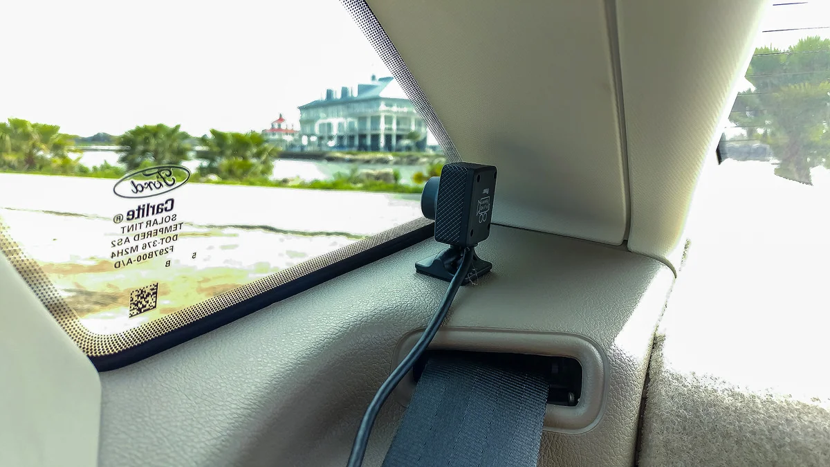

I didn't know about this thread when I posted my side mounted A119. Thought I'd simply add a link here for now (more details in the thread): https://dashcamtalk.com/forum/threads/a119-side-mounted.26352/

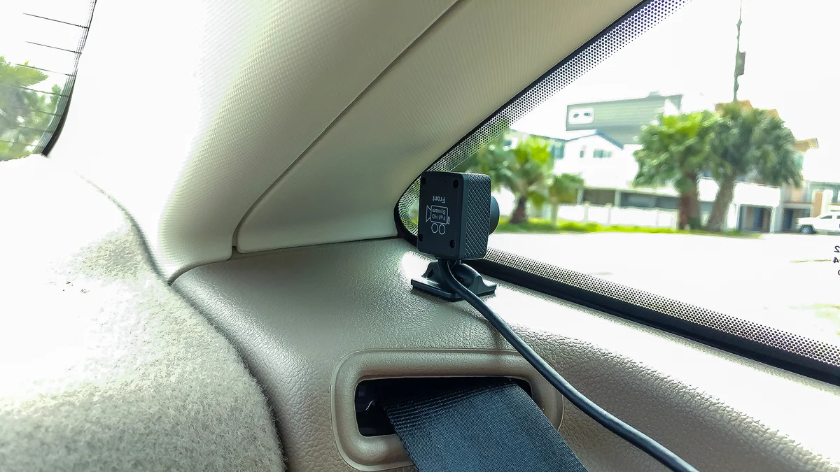

I like the Koonlung for the sides because the cameras are small and pretty much identical to each other and the fact that it's a segregated dash cam is also nice. I've seen mixed reviews about it but so far it's the only 2 channel system I can find like that. I used to be able to find one by eCell but I think it's been discontinued.

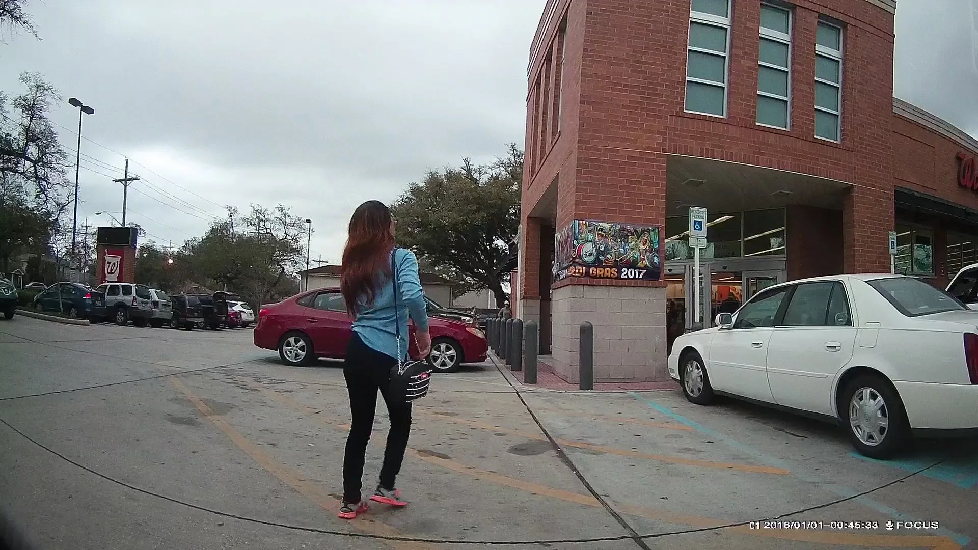

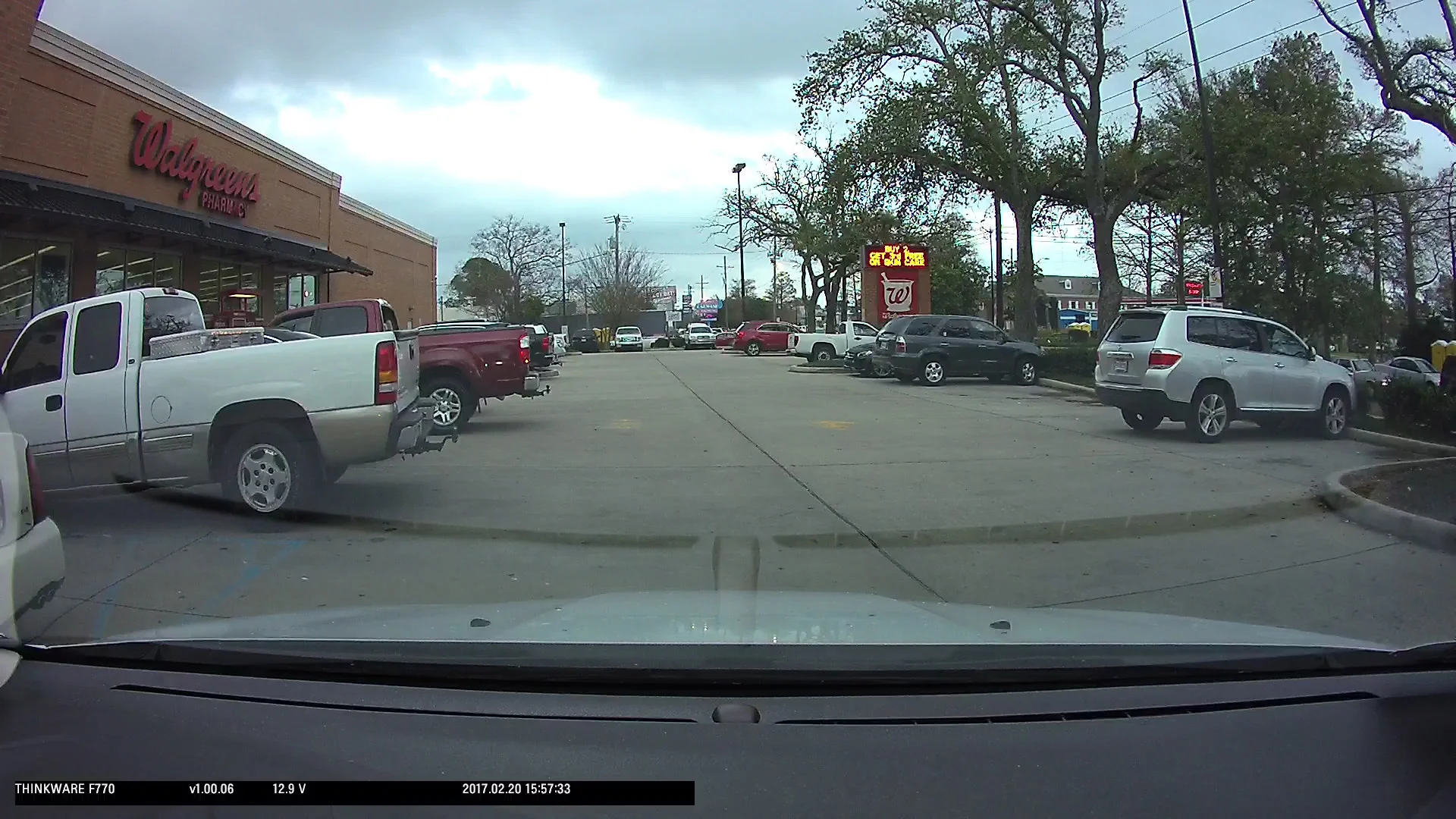

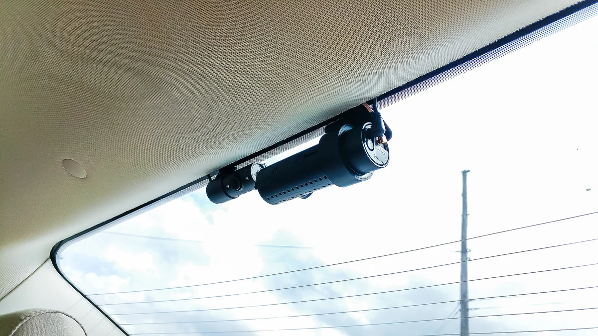

I finally got all the cameras in and everything installed. I'm still tweaking the positions of the side cameras but it's pretty good so far. I also plan on getting CPL filters for the Thinkware and ESPECIALLY the BlackVue. Also, the Koonlung's date/time reset itself for some reason.
360 View:
Setup:

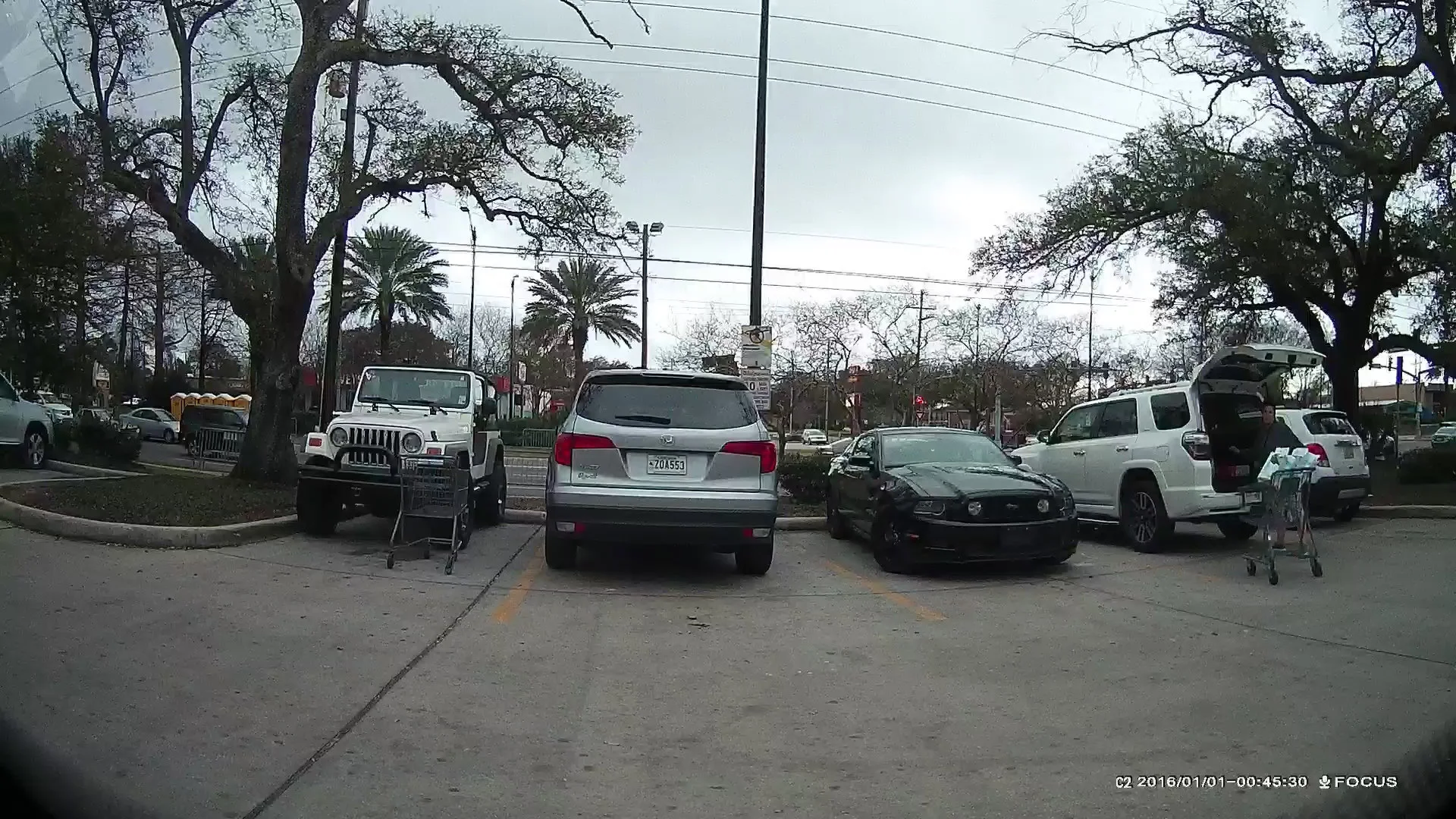

Front:
Right:
Back:
Left:
