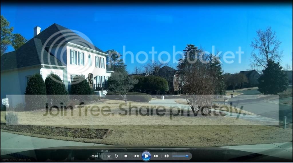

Seems pointed a little high, you may have issues in certain lighting conditions. Always try to keep the sky shots to a minimum to help the exposure focus better on the road

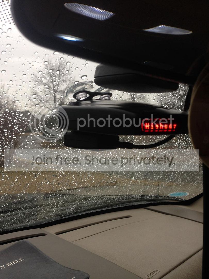

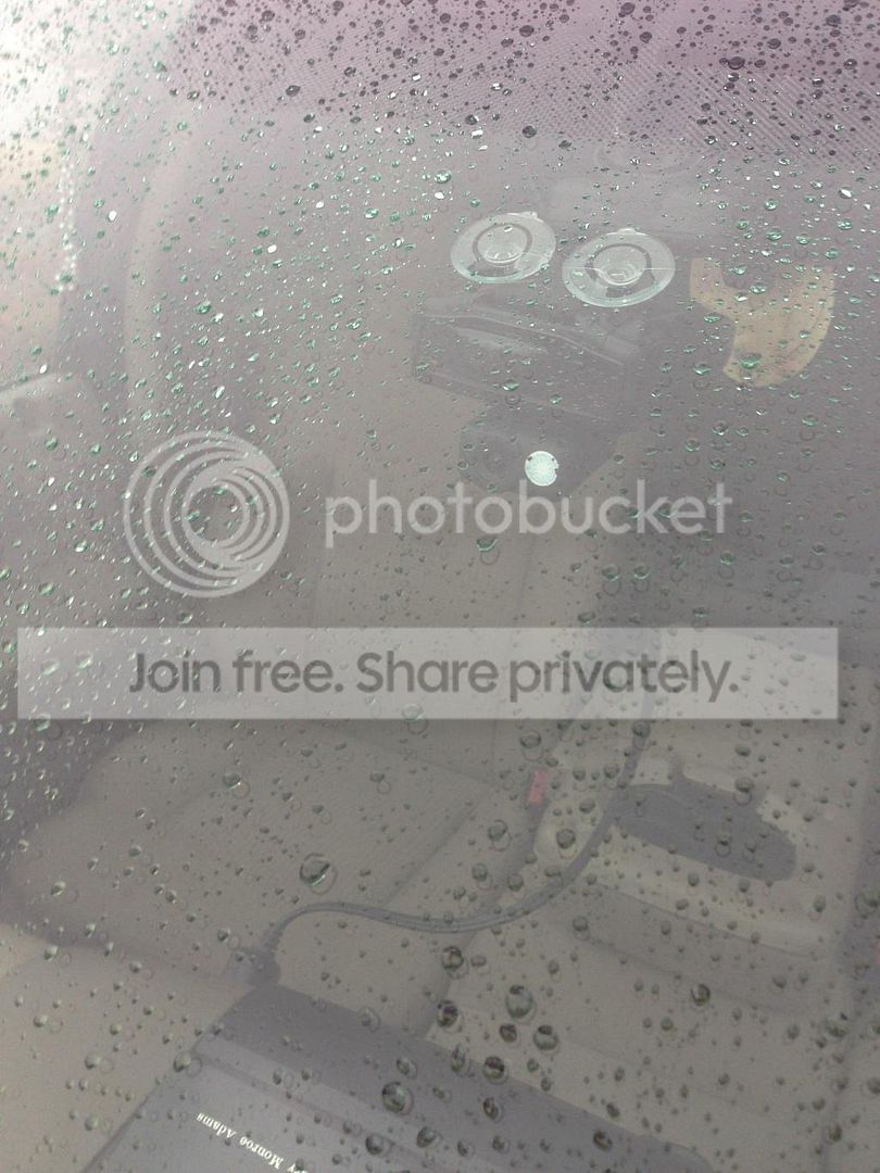

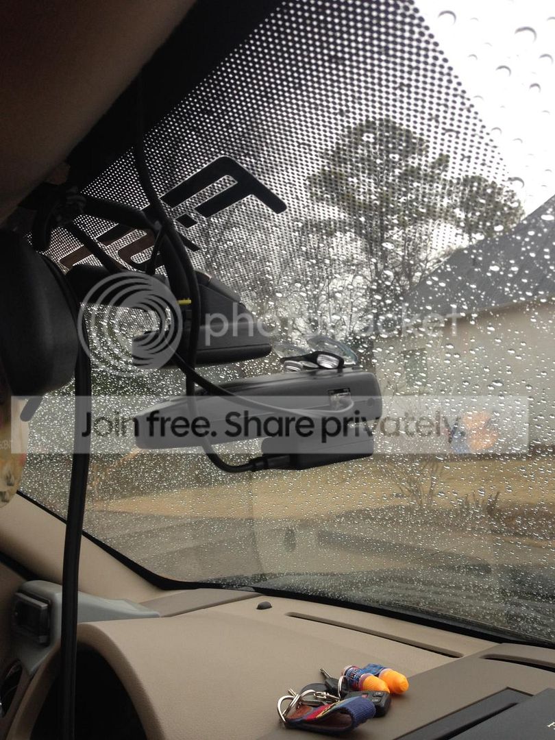

^ Not an expert by any measure but I would be very satisfied with that installation..
you might want to look at getting yourself the RF shielded case for the Mobius, it is noisy enough electrically that it may impact the performance of your radar detector being mounted like that
That's a very good point, would any old conductive metal box (or wire mesh) do, dumped to ground?
I don't think that would work, better to just try and contain the radiated EMF and keep it away from the radar detector, the detector may have some sort of way of dealing with that noise but I would think the close proximity could be less than ideal
Can you provide a link to this case? I can't seem to find it when I search online for it and want to make sure I get the right one. The radar detector still works driving past automatic doors and whatnot but I guess it is possible it could make it less sensitive or something.
