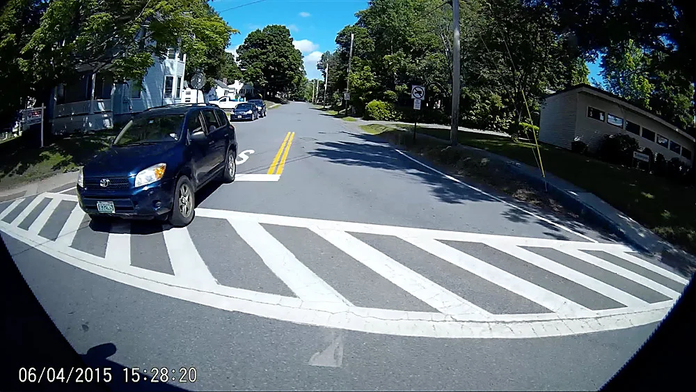

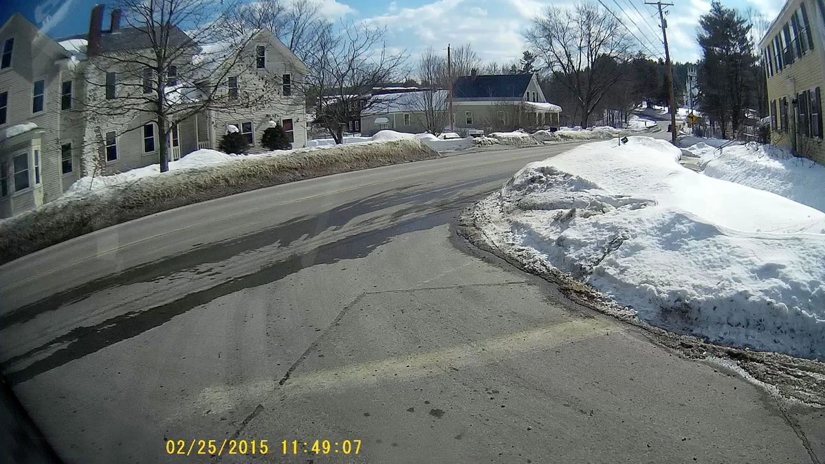

If find that the lateral facing cameras are excellent for recording what is coming at my vehicle from either side of a perpendicular street as I approach an intersection or drive past a side street. Anyone attempting to pull off the sort of scam you guys describe would get caught in the act.
Here are a couple of older examples of side cam captures of a car a full length over line on a side street stop sign and the entire right side road view of an intersection captured as I am at a stop sign.

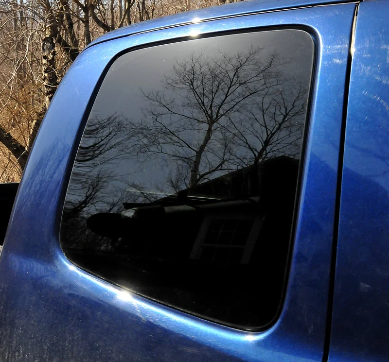

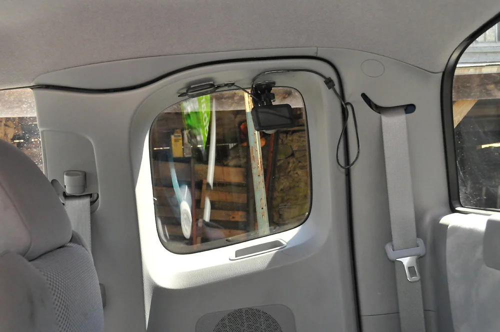

Yes, my Toyota Tacoma has the same recessed thick "windowsills" all around that make mounting side cameras much easier as they don't need to be attached to the glass. The thick design of the door make it look like it could be on an armored car. 😀
Here is what the door looks like:
When I first tried this it was with a modified GT680W, my installation was a bit crude and unsightly, especially with the GPS but it worked well. My current Mobius and 0806 installations are far more discreet and stealthy, except that they do need the strain relief loop so you can fully open the door. From outside with the tinted glass, the cameras are virtually invisible except in certain lighting when they can be seen in silhouette.
