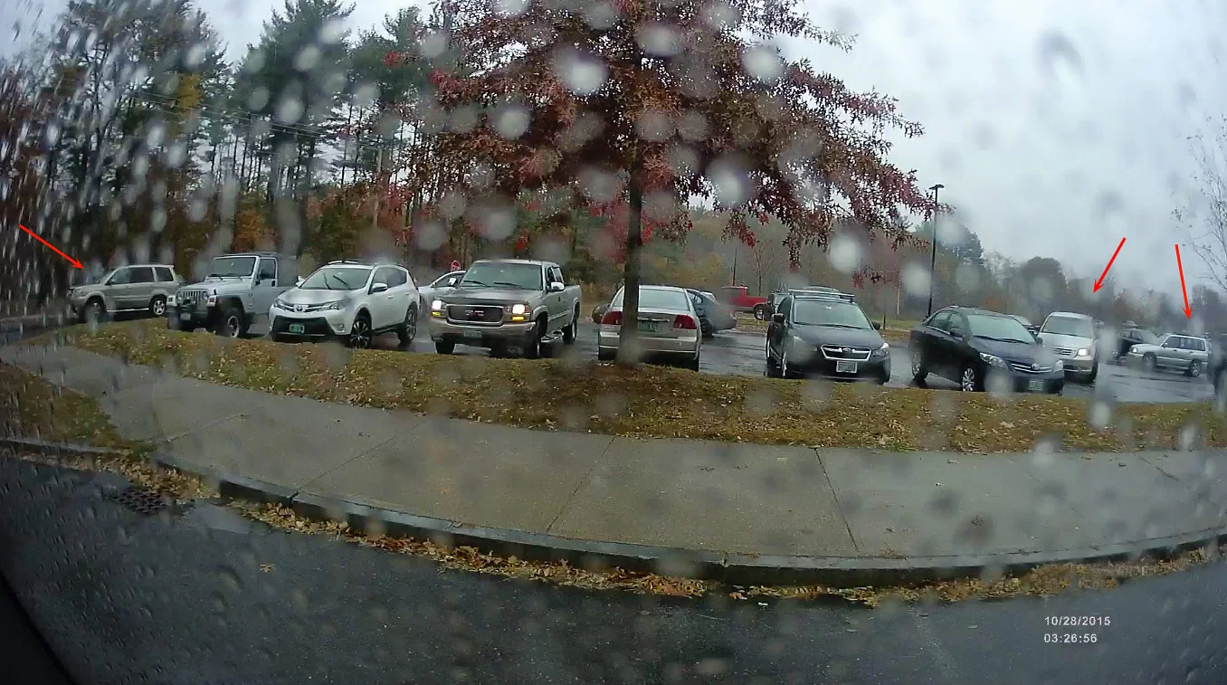

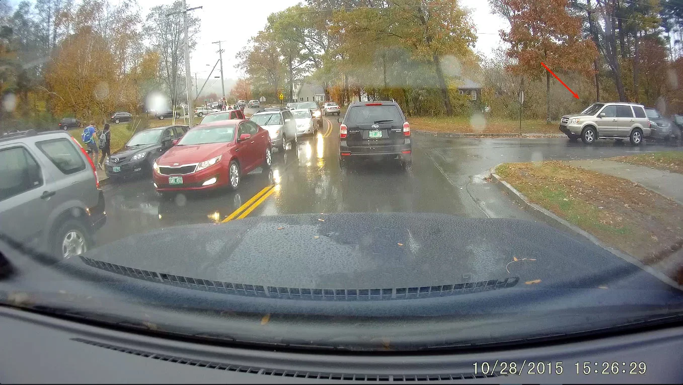

I was going through some older footage before deleting it and realized there was a good demonstration of the value of side facing cameras. With the proper lenses with adequate FOV you can essentially achieve 360° coverage on all sides of your vehicle with four cameras. In this instance I've only saved video from three cameras - front, rear and right side window but you'll get the idea. Note the cars shown with the RED arrows and you can observe how the coverage from the three cameras overlaps by a decent margin.
In this example the cameras are SG9665GC (front) - Mobius B lens (rear) and mini 0806 (right side rear window). - (I have another Mobius B lens camera on the left side - not shown)

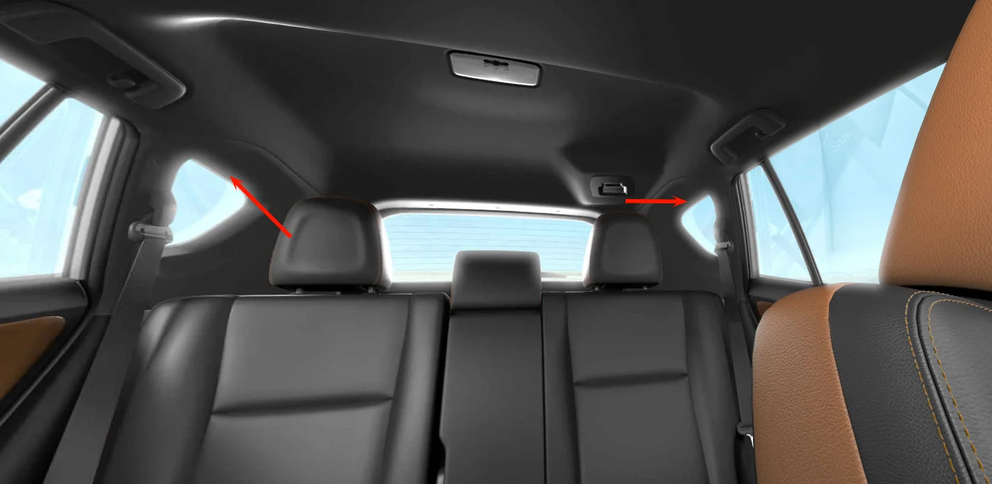

I will take photos of the side of my Rav4. If the side drink holders behind the back seat (if that makes any sense) were elevated just a little more ... I could have made it work . I believe @Gabacho has a Rav4
Of course, I don't know which Rav4 year or model you own but looking at an interior view of the 2016 Rav4, if yours has those recessed fixed panels it would the ideal place to mount side facing cameras from above. That is similar to the rear windows in my Toyota Tacoma pick-up where I've mounted my cameras.

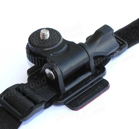

On the other side I've used a helmet mount with the strap and base plate removed, as seen in these photos and available HERE. (and elswhere)
