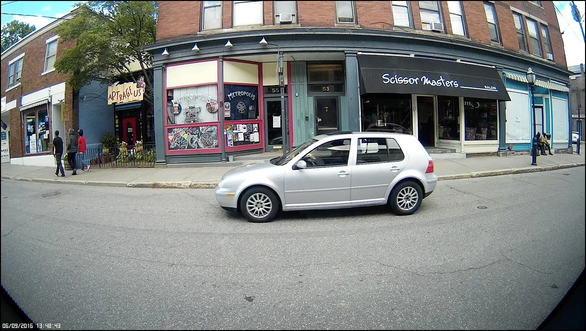

Here's an example video from a right side facing camera view while parked using a Mobius with C2 lens running on a 20,000 mAh power bank. Street views and people watching can sometimes be pretty entertaining while at the same time providing good security while away from your vehicle, especially with four cameras running in your absence.
Also, here's a screen shot out the left side rear window taken at the same time, also Mobius C2. The coverage of the C2 lens has proved itself to be the ideal side camera FOV in my experimentation and testing of side cams.
