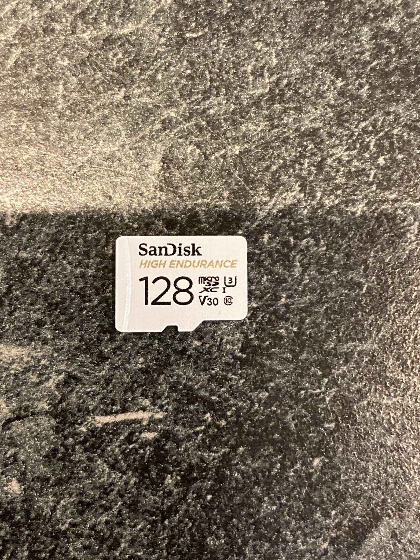

Having vented your spleen at Nextbase twice (and taken up a lot of space doing it with the silly triple spacing of sentences) do you actually have a recommendation for a reliable camera bases on your personal experience?
Here we go..
